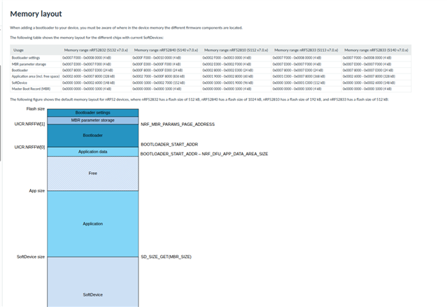

    I am unable to link and create a 'debug' build of the Nordic boot loader on my NRF52840 board if I stick with the boot loader memory layout as suggested in Nordic memory map i.e. start at 0xF8000.
    The only way I could get the entire program to link was if I expanded the boot loader to start at 0xF4000 (for NRF_LOG_LEVEL_3) or 0xF1000 (for NRF_LOG_LEVEL_4). This is really problematic at such a late stage in our product lifecycle since we have a history of using the page just below the default boot loader start address as a static, non-volatile, customer facing configuration region.
    But is this a problem if you are only doing a "debug" build? The release configuration can still have the default start address.
