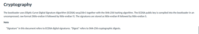

    Thanks for creating this ticket. Is this a fully customized bootloader, or can I assume it’s mostly the same as the one from the nRF5 SDK with the addition of external flash support? Also, was the init command with the signature created using nrfutil (the *.dat file)? If so, it should be sufficient to store the entire contents of that file in the .init_command member of the settings struct and let the bootloader handle the decoding and retrieval of the signature key using the stored_init_cmd_decode() function.
    Does nrf_crypto_ecdsa_verify expect the hash, signature, and key in raw big-endian or little-endian format?
    Our bootloader expects little endian.
    For the public key, should it be passed as a concatenated buffer [X || Y] or in some other internal representation?
    Please see this post  ECDSA with nrfutil generated key
    Vidar

  • It sounds like you are using the hash digest of the new FW image? Please note that the signature included in the init command (content of the *.data file created by nrfutil, see init packet) is for the init command itself. This means you need to calculate the hash digest of the init packet and not the FW to validate the signature. You can see how this is done by the nrf_dfu_validation_signature_check() function in the SDK bootloader.
    (Ref. https://docs.nordicsemi.com/bundle/sdk_nrf5_v17.1.0/page/lib_secure_boot.html

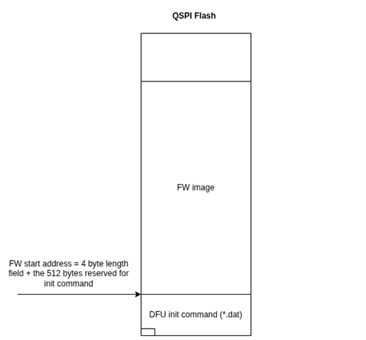

  • Were you able to make any progress on this after validating the signature of the init command instead of the FW image itself?
  • I have been working on building and flashing the bootloader with a newer development setup in VScode we have, and are not fully there yet. My plan was to go back to using more of the NRF bootloader example and then adding on the functionality that i need. From what i understand i should be able to save the content of the nrf zip package in the xflash and then handle that in the bootloader
