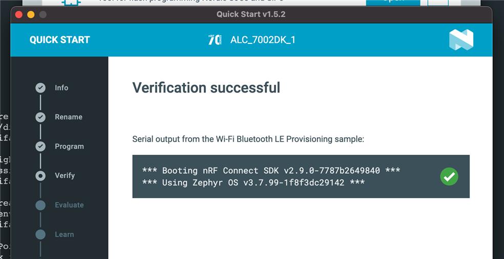

I've just completed Lesson 2 Exercise 3 and found that BLE Provisioning does not work from the iPhone version of the app.  The problem seems to be related to Version 2 of the firmware.  The Quick start version in the nRF Connect for Desktop 5.2.0 works fine and reports Version 1.

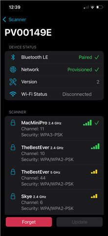

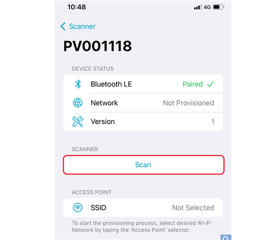

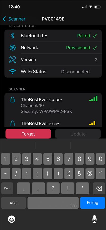

  • Hi Edvin,

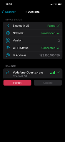

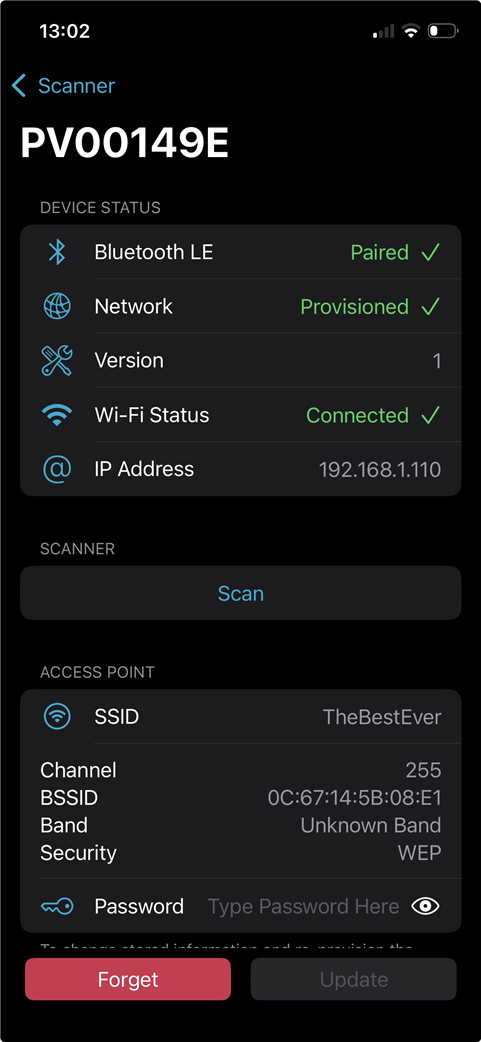

    When provisioning from the phone, a version number is shown as below.
    In sdk 3.1.0 this has been updated to 2.  This is NOT the version of the app on the phone, rather it seems to be the API version in the sdk.

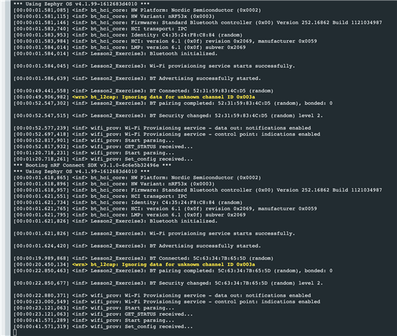

    The screen shot that I included shows that the version supplied with the Quick Start samples was compiled with sdk v.2.9.0 and works, whilst with the version in sdk 3.1.0, the DK fails to connect to the AP once provisioned.
    Exercise 1 simply requires the BLE provisioning sample to be compiled and flashed to the board.  Here the 3.1.0 sample shows Version 2 in the phone app and fails to connect. Loading the quick start version shows Version 1 and connects correctly.

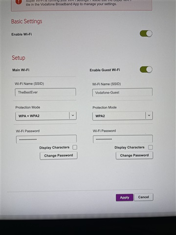

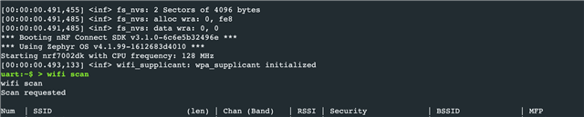

    Here are some of the errors that I have found so far:

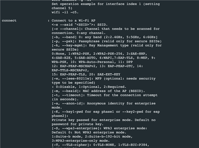

    a.  Lesson 2, Exercise 1, section 3.  WiFi shell has been updated and wifi connect has changed. The key-mgt parameters listed in the text are no longer valid.

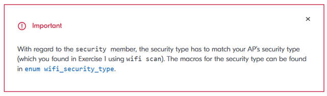

    b.  Lesson 2, Exercise 2, section 8.2, the security type has to match the user's AP. A hint to check this would be useful.
    c.  Lesson 2, Exercise 3, section 1, the configs don't match the solution.  The solution is correct.

    a. https://docs.nordicsemi.com/bundle/ncs-3.1.0/page/nrf/samples/wifi/shell/README.html
    As far as I can tell, the key-mgt parameters listed match the ones in the documentation? Please let me know if I'm mistaken.
    b. I have addressed this by adding the following notice in step 8.2.
