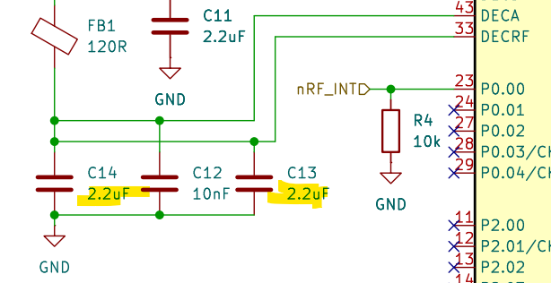

I'm trying to get a custom board based on the nRF54L10 working. I am currently connecting it to my computer via a J-Link Edu and would like to get some basic logging to work using RTT (the Edu doesn't support a virtual COM port).

I have attached the schematic of the board and the project as a ZIP-Archive below.
Can anyone help me to configure RTT logging for my custom board?
Note: I'm not 100% confident in my soldering skills, however as flashing seems to work and with the J-Link being able to retrieve information from the microcontroller I'm assuming the MCU is at least online.
8420.project.zip8880.schematic.pdf

    Though I can't just let the original problem go without commenting on it here: Looks to me as if there might be small mistake here on DECRF, and the DEC pins are generally important for the RF performance. Though that alone wouldn't explain what you are seeing here ofcourse.
    My bet is that there is something that is missoldered somewhere. Did you manually solder the entire thing? Could you check the current draw of it, and the voltage on eg. this test point TP11?
    Elfving
  • Hi, sorry for the late reply! That with the capacitors is a funny mix up, I'll have to fix that lol.
    I reflow soldered the board using a hot plate. The MCU is currently drawing a little over 1mA at 3.3V, which does down to 0.3mA when holding the reset button.
  • That does sound like a lot. What are you running on it now? Do you just have the one board that you are seeing this on? Might be an idea to compare multiple, if you had them.
