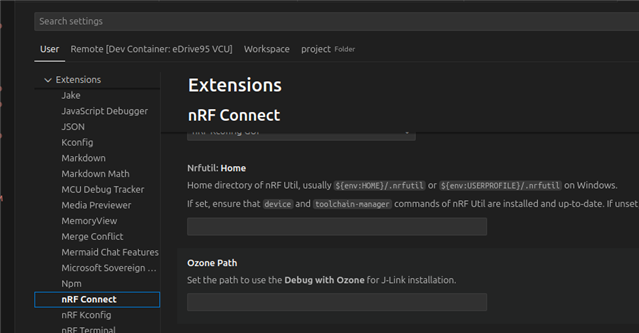

    Right, the VS Code extension needs to be installed separately from the SDK. You can install this easily inside VS Code in the Extensions tab.
    Al. said:
    If  the sdk and toolchain is installed via the command line, how to sync this with VSCode?
    If you install NCS to a custom path, you will need to point the extension to nrfutil as path information is stored in the nrfutil configuration. You will find this in the settings for the extensions (see attached image).
