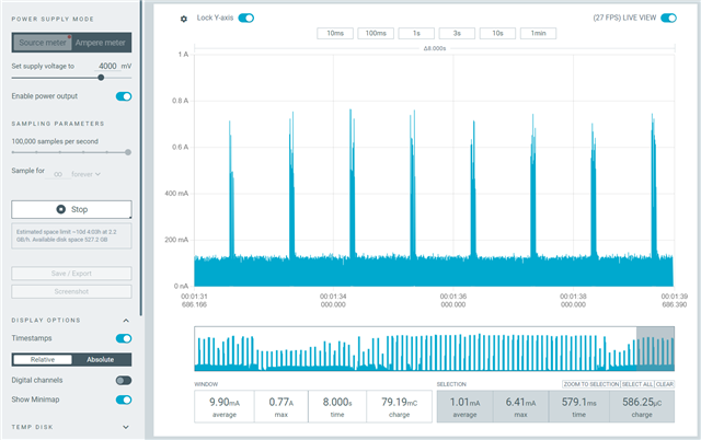

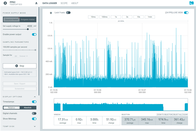

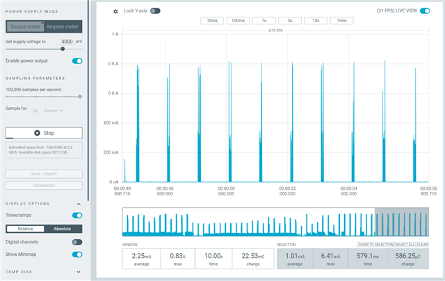

  • High (> 0.8A) "phantom" current spikes. After investigating in the Devzone, it seems they're caused because of the switching logic inside of the PPK. We can live with them because they doesn't affect the average current too much, but it's worth mentioning that we observe them way less using PPK version 4.1.2 than the latest one (as seen in this post). Also, if we try to measure after the DC/DC (for example in the 3V3 output), these spikes are not there.

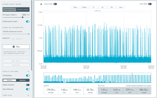

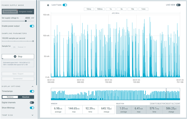

  • Variable "noise floor", that significantly increases the average current sometimes. We've tried to place a capacitor right at the output of the PPK as suggested in another Devzone post, and we observe that it helps alleviating the issue as you can see in these screenshots. Left one is without capacitor, right one with it.
Zooming on the "floor" area betweek peaks you can observe the difference too (scale is a bit different, sorry about that)
What is the reason for this behavior? Which one of the measurements should we take as the most correct one?
    This is good to hear. The version you are referring to have a built in routine that discards "unexpected" results within reason. Intention is to remove the phantom spikes, and show a more accurate result in the use case where the average current is "high". The ppk will also behave as a terminal print with this version and print out the number of discarded results.
    The reason is the same as with the high current case, there's a mode switch that distorts the both the peak and the "floor" area. The one with capacitance should be closer to the correct. When you zoom in between the peak, the floor is correct, but you miss out from the peaks in the window view. If you find average with peaks and without. It's tricky to know exactly how much the peak overshoot without longer control measurements with more advanced setups, but somewhere between average with peaks and average without would be the "right" results.
