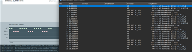

We have a Thingy:91 (nRF9160) that we use for various LTE-M / NB-IoT network debugging.
Until recently I was able to see both RRC and NAS messages in both "Cellular Monitor" app and when set to pipe directly to Wireshark. However, since rencently I can no longer see any NAS messages.
Reading various docs (AT command reference and searching Nordics online) on using AT%XMODEMTRACE, I tried several of the documented trace settings. For example, in the manual you say to use:
AT%XMODEMTRACE=<oper>[,<set_id>
So I tried:
AT%XMODEMTRACE=1,2
That didn't change anything.

    can you provide some information about what version of Cellular Monitor and SDK version?
  • Hi Hakan!
    It's kind of weird that my questions are met with a counter question...
    I'm using the latest tools provided!
    - "Cellular Monitor" v.2.6.0
    - IDK, where to find the SDK version?
    However, the FW that's on the device was compiled and loaded 2+ years ago, on a different machine, so I don't recall what was the SDK then. But, as I said, it was working fine just like before until ~3 weeks ago until I updated all tools. I didn't realize immediately that it might have to do with the updated tool. I suppose maybe they are sending some different initialization commands or strings to the modem?
    It would be more helpful if you could explain how the bitmap works and why the NAS is not mentioned and part of the LTE tarce?
    I have 50k sized binary traces, but when looking at the supposed pcapng equivalent with wireshark there are only 2 lines from AT and RRC commands!

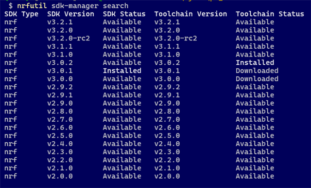

  • I had this at the time.
    I tried to upgrade, but got another error...
    It's not an error, it's a warning. And I believe you should not worry too much about it, it is intended behavior;

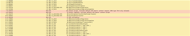

    For the record, I tested this using cellular monitor v2.6.0, and SDK v3.2.0. Modem tracing enabled using snippets. As far as I know, no need to run the AT%XMODEMTRACE=1,2 command at all, but you can probably do that too. Here is what I got;
    So everything is working as intended on my end.
    You may not like being asked questions here, but I will need to ask you to provide more information. Because I am not able to replicate your issue. Please describe in detail your setup including SDK version and mfw version, how you enabled modem tracing etc.
