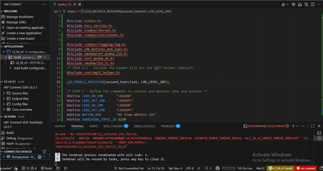

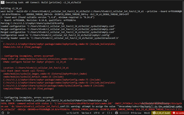

i'm learning l4/e1 and i'm trying to buid the process after finishing step 10 but the build didn't goes through successfully. i got this errors
my SDK & toolchain version is 3.2.1. i'm using nrf9160dk rev2. please can anyone tell me the solution for this error.
thanks

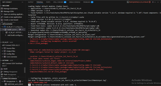

  • Hi Vivek,
    When checking for errors, and there is nothing relevent in the Build terminal, I would recommand to do a pristine build. That way, It is more likely to get a proper error log.
    In your case, if you pristine build you can see :
    -- Found devicetree overlay: /home/sido/ncs/v3.2.2/zephyr/boards/nordic/nrf9160dk/nrf9160dk_nrf9160_ns_0_14_0.overlay
    -- Generated zephyr.dts: /home/sido/Downloads/c2_l4_e1/build/c2_l4_e1/zephyr/zephyr.dts
    -- Generated pickled edt: /home/sido/Downloads/c2_l4_e1/build/c2_l4_e1/zephyr/edt.pickle
    -- Generated devicetree_generated.h: /home/sido/Downloads/c2_l4_e1/build/c2_l4_e1/zephyr/include/generated/zephyr/devicetree_generated.h
    /home/sido/Downloads/c2_l4_e1/prj.conf:32: warning: attempt to assign the value '"devacademy/publish/topic"' to the undefined symbol MQTT_SAMPLE_PUB_TOPIC
    /home/sido/Downloads/c2_l4_e1/prj.conf:33: warning: attempt to assign the value '"devacademy/subscribe/topic"' to the undefined symbol MQTT_SAMPLE_SUB_TOPIC
    Parsing /home/sido/ncs/v3.2.2/zephyr/Kconfig
    Loaded configuration '/home/sido/ncs/v3.2.2/zephyr/boards/nordic/nrf9160dk/nrf9160dk_nrf9160_ns_defconfig'
    Merged configuration '/home/sido/Downloads/c2_l4_e1/prj.conf'
    Merged configuration '/home/sido/Downloads/c2_l4_e1/build/c2_l4_e1/zephyr/misc/generated/extra_kconfig_options.conf'
    Merged configuration '/home/sido/Downloads/c2_l4_e1/build/c2_l4_e1/zephyr/.config.sysbuild'
    error: Aborting due to Kconfig warnings
    This error tells us that some of the Kconfig that you tried to set are not defined anywhere.
    And if you check at the source project for this lesson, you can see that there is a file called "Kconfig" that you are missing.
    This "Kconfig" file is a file that allows the user to have some custom Kconfig configuration for the project. In this lesson, it has been used to add the two configs that are creating errors.
    If you add that Kconfig file to your project, it should be able to build fine.
