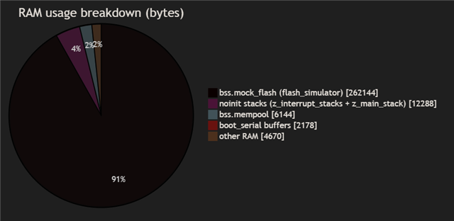

The problem is that the ram is overflowed by a lot due to the mock_flash partition:
-- Zephyr version: 4.1.99 (/workspace/_nordic_sdk/zephyr), build: ff8f0c579eeb
[202/207] Linking C executable zephyr/zephyr_pre0.elf
FAILED: zephyr/zephyr_pre0.elf zephyr/zephyr_pre0.map /workspace/_obj/app/baseband_nordic/sdk_3_1/mezza_nordic/mcuboot/zephyr/zephyr_pre0.map
: && ccache /opt/ncs/toolchains/b2ecd2435d/opt/zephyr-sdk/arm-zephyr-eabi/bin/arm-zephyr-eabi-gcc  -gdwarf-4 zephyr/CMakeFiles/zephyr_pre0.dir/misc/empty_file.c.obj -o zephyr/zephyr_pre0.elf  zephyr/CMakeFiles/offsets.dir/./arch/arm/core/offsets/offsets.c.obj  -T  zephyr/linker_zephyr_pre0.cmd  -Wl,-Map=/workspace/_obj/app/baseband_nordic/sdk_3_1/mezza_nordic/mcuboot/zephyr/zephyr_pre0.map  -Wl,--whole-archive  app/libapp.a  zephyr/libzephyr.a  zephyr/arch/common/libarch__common.a  zephyr/arch/arch/arm/core/libarch__arm__core.a  zephyr/arch/arch/arm/core/cortex_m/libarch__arm__core__cortex_m.a  zephyr/arch/arch/arm/core/cortex_m/cmse/libarch__arm__core__cortex_m__cmse.a  zephyr/arch/arch/arm/core/mpu/libarch__arm__core__mpu.a  zephyr/lib/libc/picolibc/liblib__libc__picolibc.a  zephyr/lib/libc/common/liblib__libc__common.a  zephyr/soc/soc/nrf5340/libsoc__nordic.a  zephyr/boards/boards/arm/mezza_nordic/lib..__..__modules__phc_boards__boards__sonova__mezza_nordic.a  zephyr/subsys/retention/libsubsys__retention.a  zephyr/drivers/clock_control/libdrivers__clock_control.a  zephyr/drivers/flash/libdrivers__flash.a  zephyr/drivers/gpio/libdrivers__gpio.a  zephyr/drivers/pinctrl/libdrivers__pinctrl.a  zephyr/drivers/regulator/libdrivers__regulator.a  zephyr/drivers/retained_mem/libdrivers__retained_mem.a  zephyr/drivers/serial/libdrivers__serial.a  zephyr/drivers/timer/libdrivers__timer.a  modules/nrf/lib/fprotect/lib..__nrf__lib__fprotect.a  modules/nrf/subsys/pcd/lib..__nrf__subsys__pcd.a  modules/nrf/modules/mcuboot/hooks/lib..__nrf__modules__mcuboot__hooks.a  modules/nrf/drivers/hw_cc3xx/lib..__nrf__drivers__hw_cc3xx.a  modules/mcuboot/boot/bootutil/zephyr/libmcuboot_util.a  modules/hal_nordic/modules/hal_nordic/nrfx/libmodules__hal_nordic__nrfx.a  modules/zcbor/libmodules__zcbor.a  -Wl,--no-whole-archive  zephyr/kernel/libkernel.a  -L/workspace/_obj/app/baseband_nordic/sdk_3_1/mezza_nordic/mcuboot/zephyr  zephyr/arch/common/libisr_tables.a  -mcpu=cortex-m33  -mthumb  -mabi=aapcs  -mfp16-format=ieee  -mtp=soft  -fuse-ld=bfd  -Wl,--gc-sections  -Wl,--build-id=none  -Wl,--sort-common=descending  -Wl,--sort-section=alignment  -Wl,-u,_OffsetAbsSyms  -Wl,-u,_ConfigAbsSyms  -nostdlib  -static  -Wl,-X  -Wl,-N  -Wl,--orphan-handling=warn  -Wl,-no-pie  -specs=picolibc.specs  -DPICOLIBC_MINIMAL_PRINTF_SCANF  /workspace/_nordic_sdk/nrfxlib/crypto/nrf_cc312_platform/lib/cortex-m33/soft-float/no-interrupts/libnrf_cc312_platform_0.9.19.a -L"/opt/ncs/toolchains/b2ecd2435d/opt/zephyr-sdk/arm-zephyr-eabi/bin/../lib/gcc/arm-zephyr-eabi/12.2.0/thumb/v8-m.main/nofp" -lc -lgcc && cd /workspace/_obj/app/baseband_nordic/sdk_3_1/mezza_nordic/mcuboot/zephyr && /opt/ncs/toolchains/b2ecd2435d/usr/local/bin/cmake -E true
/opt/ncs/toolchains/b2ecd2435d/opt/zephyr-sdk/arm-zephyr-eabi/bin/../lib/gcc/arm-zephyr-eabi/12.2.0/../../../../arm-zephyr-eabi/bin/ld.bfd: zephyr/zephyr_pre0.elf section `bss' will not fit in region `RAM'
/opt/ncs/toolchains/b2ecd2435d/opt/zephyr-sdk/arm-zephyr-eabi/bin/../lib/gcc/arm-zephyr-eabi/12.2.0/../../../../arm-zephyr-eabi/bin/ld.bfd: region `RAM' overflowed by 91745 bytes
I have followed these guides:
MCUboot’s serial recovery of the networking core image
nRF5340: Network core bootloader
Any idea what is wrong?
The AI suggest to reduce the size of the sim_flash to fit only the hci_ipc image and effectively some memory are spared:
/opt/ncs/toolchains/b2ecd2435d/opt/zephyr-sdk/arm-zephyr-eabi/bin/../lib/gcc/arm-zephyr-eabi/12.2.0/../../../../arm-zephyr-eabi/bin/ld.bfd: region `RAM' overflowed by 58977 bytes
But I still need to spare ~58k

  • I have found my problem and it was simply that I have copy paste blindly from this guide: Retention System the following line:
    /* Reduce SRAM0 usage by 1 byte to account for non-init area */
    &sram0 {
            reg = <0x20000000 0x3FFFF>;
    The problem is that by doing that I have not only removed 1 byte but ~256Kb of RAM.
    From this change everything started to be messy and the partition manager becoming to be out of sync from the dts configuration.
    Several things that I have learned the hard way and is maybe important to mention here are the following points:
    • rpmsg_nrf53_sram is automatically created by nordic but only the size is taken from the dts not the position. Make sure to check that the partition start address match the reserved memory sram0_shared
    • The compilation of the nordic firmware is based sometimes on partition_manager and sometimes on the dts configuration. Changing the position of a partition inside pm_static.yml will not necessarily have the intended effect.
    • If the compilation fail due to a linker error one solution may be to fix the problem is to remove the pm_static.yml file and look what changed as I said sometimes some fields inside pm_static depend on the project configuration and cant be modified directly isnide pm_static.yml

    # serial recovery netcore
    CONFIG_BOOT_IMAGE_ACCESS_HOOKS=y
    CONFIG_FLASH_SIMULATOR=y
    CONFIG_FLASH_SIMULATOR_DOUBLE_WRITES=y
    CONFIG_FLASH_SIMULATOR_STATS=n
    CONFIG_MCUBOOT_SERIAL_DIRECT_IMAGE_UPLOAD=y
    CONFIG_NRF53_RECOVERY_NETWORK_CORE=y
    CONFIG_PCD_APP=y
    # Decrease memory footprint
    CONFIG_SIZE_OPTIMIZATIONS=y

    sysbuild/mcuboot_flash_sim_size.overlay:
    /* Keep flash simulator size aligned with netcore upload mediator partition
     * for nRF53 serial recovery in one-image-pair mode.
    &flash_sim0 {
    	reg = <0x00000000 0x00038000>;
    &slot2_partition {
    sysbuild/CMakeLists.txt:
