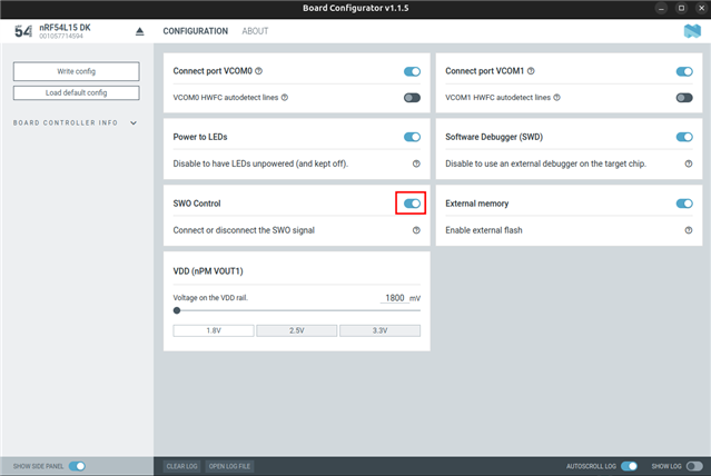

  • Hi Damian,
    You need to enable SWO control in the board configurator:
    Please note that this is only supported on nRF54L15 DK v1.0.0 and newer.

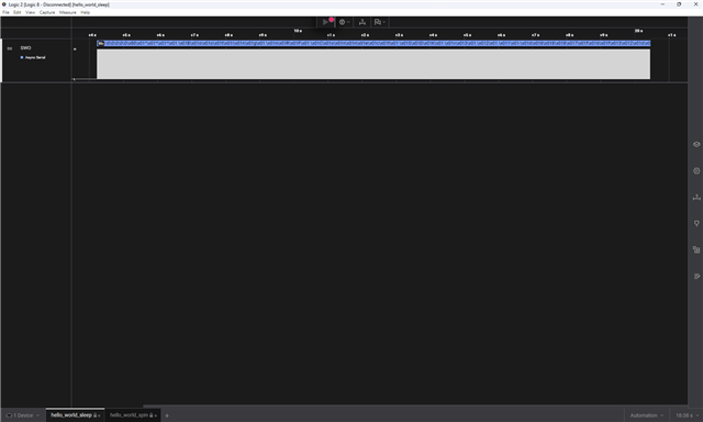

    I have attached a logic analyzer to SWO pin to see what really is happening on the wire. It occurs, there is unexpected data sent via SWO. Here are the waveforms:
    hello_world_sleep.sal

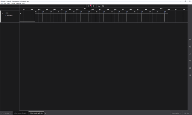

    I modified the application so that it does not use `k_msleep` function but a spin wait instead, like this:
    static void spin_wait_ms(int64_t duration_ms)
        const int64_t start_ms = k_uptime_get();
        while ((k_uptime_get() - start_ms) < duration_ms) {}
    After that the logs look correctly. The waveforms:
    hello_world_spin.sal

  • Hi Marte,
    1. I use the config CONFIG_LOG_MODE_IMMEDIATE=y. The thing is that the logs are not truncated, they are sent among other random bytes (not printable), it can be seen in the `hello_world_sleep.sal` attached to my previous comment.
