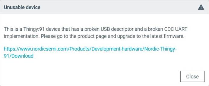

1. Programmer detects MCUBOOT, but it is descripted as “unusable device”.
2.  Programmer displays following error message which indicates that USB descriptor and CDC UART implementations are broken.  Because of this, flashing via Programmer is not possible. There is no information about this error on the linked page (only firmware packages are available there).

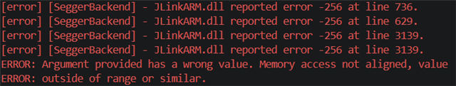

3.While using Visual Studio Code with nRF Connect Extension (nRF Connect SDK V.2.7.0, nRF Connect SDK Toolchain v2.7.0), running 'west flash -d xxxx --dev-id .01' command reports errors related to SeggerBackend.

  • Hello, what version of the Thingy:91 are you using? If the programmer app is not able to detect the device i.e. described as an “unusable device”, then most likely you must use an external debug probe e.g. nRF9160DK.

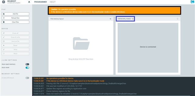

    - When device is connected via SWD while uploading my firmware, it seems that the uploading has been finished correctly (using Erase & Write button). However, the application doesn’t seem to run – the LED does not change its state. I observe the same issue with other custom firmware as well, including BLE beacon advertising samples.
    - When I connect Thingy91 via USB directly to the computer and make the device enter MCUBOOT, the Programmer tool reports the following error - “No operation is possible.” Moreover, the family of the device is unknown. This preventt me from uploading or reading firmware thorugh USB.
