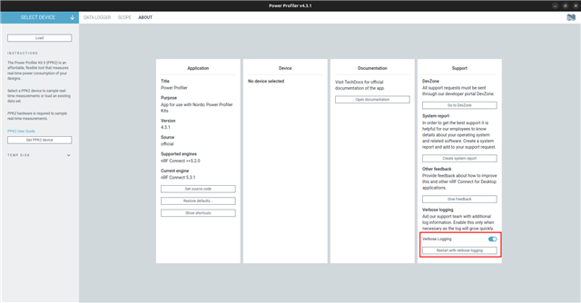

    Do you have the PPK open in the Programmer app or another app? Make sure "auto reconnect" is not enabled.
    Can you collect verbose logs? Make sure the PPK2 is connected to the computer and turnet on, then go to the "about" tab in the Power Profiler and enable verbose logging. After enabling it, select "restart with verbose logging".
    Once it has restarted, click on "open log file" at the bottom, or find the log in ~/.config/nrfconnect/pc-nrfconnect-ppk/logs. Please upload the log using Insert > Image/video/file, or copy the contents into Insert > Code.

    Is this the log with verbose logging enabled? You should see some logs of it looking for devices, like this:

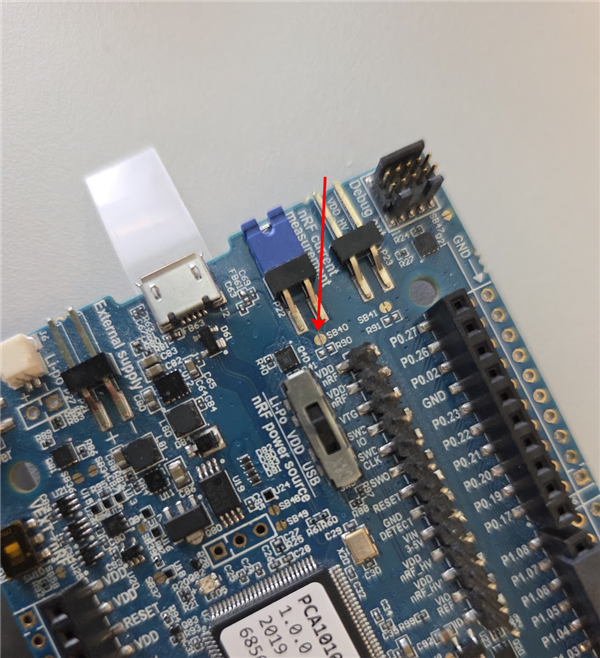

    I connected a nRF52840 DK and the PPK2 according to (4 Quickstart/p.7):
    https://docs-be.nordicsemi.com/bundle/ug_ppk2/attach/PPK2_User_Guide_v1.0.1.pdf?_LANG=enus
    After selecting Ampere meter and start, I saw contimuous current consumption of approx. 570nA.
    Then, I started a Program on the DK - but alas, the measurement continues to be those 570nA.
    This already leads to questions:
    1) The switch on nrf DK is set to VDD (avail USB/VDD/LiPo). Do I need to change that?
    2) There are some hints on: https://docs.nordicsemi.com/r/bundle/ug_nrf52840_dk/page/ug/dk/hw_measure_current.html
    a) There are PINs listed (e.g. SB40/SB41) but not described - what do I need to do in case of wanting to measure current?
    b) It is written: Note: The current measurements are unreliable if a serial terminal is connected to the virtual serial port.
    Now I need the virtual UART provided via USB - does that note refer to that UART or to a physical UART only?

  • Hi Richard,
    No, the switch should be set to VDD
    You need to cut SB40, as you can see in  nRF52840 Current measurement - Set up the DK. In other words, take a scalpel or something else sharp and cut the small connection between the two semicircles. It's a bit difficult to see, but here you can see my nRF52833 DK, where I have cut SB40:
    It means if you have the UART open in a serial terminal, so if you have it open for logging or similarly.
