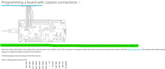

    It has to be related to voltage levels and connections. Also make sure to use short wires (less than 10 cm). For NRF5340 DK, it is mentioned that the external board should have 3 V to be able to detect and program it (if supplied by USB). So if possible please try to increase voltage supply of your external board to 3 V and see if the behavior changes or not.
    Please check the connections to see if they match with below page schematic:
    Programming a board with custom connections • nRF5340 DK Hardware • Technical Documentation
