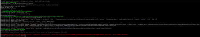

  4. In the root project directory successfully executed the command
    west build -b nrf9151dk_nrf9151 -p=always scratch
  5. I attaches the nrf9151dk board to an usb type-C port in the PC.
    Immediately a Windows Explorer popped up showing that an usb mass storage
    device was detected. In the VM in the root project directory I unsuccessfully
    executed west flash --build-dir scratch/build --runner jlink obtaining this
    error screen

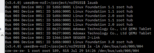

    A few things, in your recent comment you input productod instead of productid. That might just be a typo, but just in case it wasn't QEMU might error from that or ignore the typo. Also, could you run lsusb, I am curious to see if your VM was able to grab the USB.
    If not, we can try to see if device is shared in the first place. Just open up powershell on your Windows Host and run usbipd list. If the USB device has been binded properly, you should see "Shared" next to it and if it is claimed by your VM, you should see "Attached".
    Best,
    Adam
  • Hi Adam,
    the prodctod you refer was an typing error.. I meant to write productid.
    Below I repost the output of lsusb:
    So it seems that the VM is able to grab the USB.

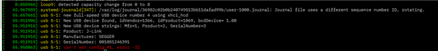

    Also here is the output from dmesg:
    It seems that the composite USB for the J-Link cannot be configurated.
    I googled around to see if there is information about that error, I found
    most configuration errors with value -71 but not -32.

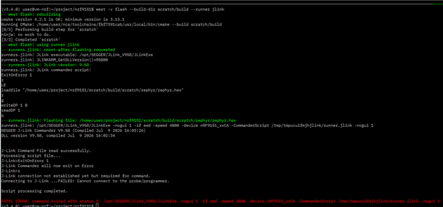

  • I tried to reproduce the fix you suggested, but this time the flashing command
    fails with the following errors:
    It seems this time it trying to upload a new firmware in the J-Link OB component
    on the nRF9151DK board.
  • Strange. Unbind the device from the VM for now and check J-link commander on your host and see if there are any updates. If it does not try rebinding and reattaching the device to the VM.

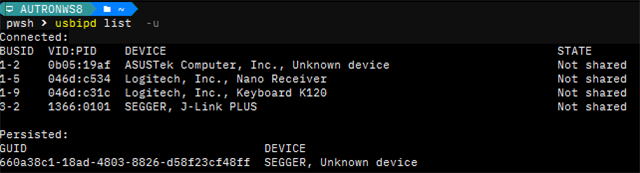

  • I have not J-Link installed on the Win10 Host..
    Before to execute the west flash on the ubuntu guest, on the Win10 host the
    usbipd list showed:
    Also on Ubuntu guest the lsusb -t command reported:
    After executing west flash on the ubuntu guest (that failed trying to reload fw on J-Link OB)
    the usbipd list -u reported instead this information:
    And on Ubuntu gurst lsusb -t showed that the nordic board is no more present as USB device:
    I'm stuck..
