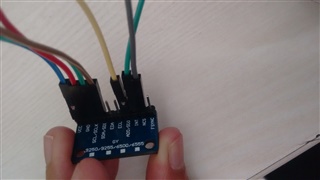

Hi ,I am using nrf52 DK with mpu9255.I am using source code given here here.of this link,I have taken 'nrf5-ble-data-ready-interrupts' example .code builts fine in keil v5 though.I am not getting accel values.
help will be appreciated.

hi ,
Default pins specified in nrf_drv_mpu_spi.c are pin 4,28,3,29.do I need to connect these 4 wires as shown in image
Can you try download a fresh copy of the examples from github and try again: Please use the pin described in the example:
In nrf_drv_mpu_spi.c:
#define MPU_SPI_MISO_PIN 28 // MPU SDO. 'AD0' on MPU breakout board silk screen #define MPU_SPI_MOSI_PIN 4 // MPU SDI. 'SDA' on MPU breakout board silk screen #define MPU_SPI_SCL_PIN 3 // MPU SCLK. 'SCL' on MPU breakout board silk screen #define MPU_SPI_CS_PIN 29 // MPU nCS. 'NCS' on MPU breakout board silk screen

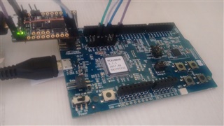

I tried with fresh code form github.i am not able to see accel values .but before getting values i should get MPU BLE device in nrf connect Application.But i dont see such device under 'SCANNER' option in nrf connect (downloaded from nordic website).

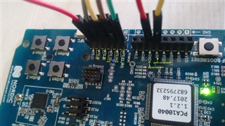

i am using default pins as given in example.I am connecting pins as shown in image.Please have a look and correct me if wrong .
I have programmed nrf52 with softdevice s132.I have checked supply for MPU9255 (5v w.r.t GND) as shown in image and its 5 V dc
Have you remembered to program the Softdevice?
Can you program the attached test.hex file. That contains the softdevice and the application and should work. If not there is something wrong with your HW or wiring.

Here you go:
Did you try my test hex file?
Note that I have bypassed the voltage regulator on my MPU9255 breakout board with a solder bridge. Hence I can feed it with VDD from my nRF52DK, and not 5V as it seems like you do.
Yes ...Its working now with both SPI/TWI.
