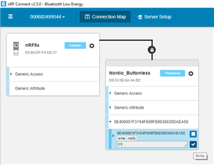

    9. Now, connect to the Nordic_Buttonless, and write 0x01 to the service with a lot of numbers and letters:
    10. The device will disconnect again. If you do another scan, you will see that it advertises again with DfuTarg. If you connect to this, you should be able to perform the DFU again with the new (!) DFU image that we created in 8.
