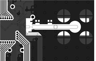

I am designing a simple broadcaster using an sma connector for a dipole antenna.
I have added a 50 ohm SMA connector to the reference deign
so you can see above is the placement of the SMA and the mid plane keep out. I have also added vias to join the ground planes and have omitted the bottom layer as its a complete fill.
There are vias next to the antenna feed point to join the bottom layer as much as possible.
1. Should the mid plane be bulged out for where the antenna feed pad starts to come closer?
2. is there any length considerations to the main feed line?
3. the output from the chip is from an internal balun, why are there balancing caps/conductors.
4. will this still need to be tuned for the board or is there a high likelyhood of the refrence design allready be suited for the SMA/50 ohm dipole.
  • Addendum:
    I made the sma connector surface mount, is there any considerations when making it a through hole component.
  • 1. You need to have the bottom layer as solid ground plane. Technically, you don't need the cut out on the inner layers either, but it doesn't harm. The transmission line must be calculated depending on the PCB stack up. The dimensions of the transmission like hence depends if you have a cut out in the inner layers or not.
    You want to use a "co-planar waveguide" as  the transmission line. You can find online calculators.
    2. Not unless it's very long.
    3. The output isn't 50 ohm so some external impedance transformation is needed. The components also do low pass filtering of the harmonics.
    4. If you follow the reference design exactly, there should be no need to tune anything.
    Using a through hole or surface mount connector matters little.

    I looked at the Co-planar waveguide calculations and they came up with about 60ohm.
    Calculator_1
    Calculator_2
    Relative Dielectric Constant = 4.2
    Track Width = 30mil = 0.762mm (as per reference design)
    Track Spacing = 10mil = 0.254mm (as per design rules)
    Board Height = 64mil = 1.6mm
    copper height = 1.4mil = 0.035mm
    One way I managed to get close to 50 ohms was to use 0.5mm between guide and ground plane, so this would mean using a 0.8mm board and ground plane on the 3rd layer.
    looking at the space left in the SMA connector there isn't much room to change track thickness and gaps.
    Am I simply over analysing this or will 10 ohms cause a disturbance in the signal,
    I am using rssi for distance calculation and am trying to get the most uniform and stable signal across multiple copies of this device.
  • You can adjust the impedance with the width of the track as well. But 60 ohm is good enough. You can find calculators to help you find the loss due to the slight mismatch. With a 60 ohm transmission line (and antenna load impedance to make it easier), the loss is only 0.04 dB.
  • I don't want to get too involved here since you have a big thread going on with ketilijo but...
    1. You should model your surface mount connector and not just assume that if you get the CPW on the board correct everything works out.  The feed pin on that SMA is massive and the resulting capacitive coupling to the board is severe.  Normally, SMA's have almost no ground near the feed pin as a result.  So, you need to model it in an EM simulator and/or follow the manufacturers layout guidelines.
    2. When switching to thru hole the resulting capacitance from the feed pin to the surrounding layers is even more severe.  As you have shown it above, switching that to thru hole would likely be close to a short at 2.4GHz.  Again, model the solution and don't guess or you won't be happy with the results.
    3.  Unless you have need of the right angle to board solution that thru hole provides you will get a more reliable RF solution with all the same mechanical qualities of thru hole by using an end launch sma connection instead.  Then the CPW just goes straight onto the feed pin since it is all characterized.  Normally end launch with a tab center pin is preferable to those with the round center pin for RF purposes.  But at 2.4GHz a round center pin isn't too bad.
