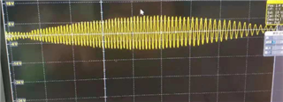

Hello, I want to use nrf52832 to output waveforms as shown above.
Using the Demo1 example in D: Lianxi nordic nRF5_SDK_12.2.0_f012efa examples peripheral pwm_driver, we want to change the frequency output, from large to small, and then from small to large free automatic loop output.
Let's take a look. What's wrong with the frequency? Thank you.

  • Hello, thank you for your reply, this is changing the duty cycle, and I want to change the frequency. Is there any way?
    Sorry my bad, I thought you meant duty cycle. Take a look at Rune's answer in this similar devzone post.
    With the PWM hardware the top value is set during init so you will need to uninit and init each time you change it.
    I will need some time to test the code for a solution using timers, GPIOTE and PPI if you want to go that way.
    Best Regards,
    Marjeris
  • Hello, nrf52832 does need to change the frequency PWM output, your program help, thanks.
