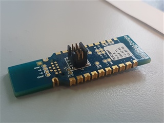

  • Hi.
    You need to solder a ARM Cortex JTAG SWD 10pin Connector onto footprint P1, and either connect that to a external debugger or a development kit, like this:
    Connected to a development kit it looks like this:
    And connect the Dongle to a USB port
    Note: it is really important that the voltage on the nRF52840 Dongle matches the nRF52832 DK if you do it this way.

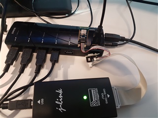

    If you want to use an external debugger, you could connect it like this:
    And connected the Dongle to a USB port:
    And also connected it to a debugger (I'm using the J-Link BASE here)
    Then you just have to use the IDE you wish to use to debug.
    - Andreas
