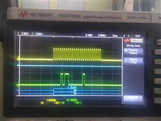

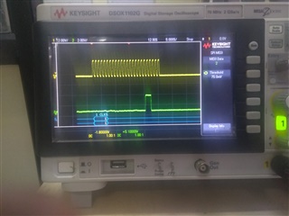

  • Hello Sir,
     As per your guide line I set SPI frequency to 1MHz and try to read register 0x01 (having device MEMS ID).
     I am getting wrong value 0x18 instead on 0x1D (default value).
     Here attached waveform of CLK & MOSI pin.
    CLK & MOSI pin
    Waveform for CLK & MISO pin
    CLK & MISO
     Data we are sending on MOSI is 0x0B (Read register command) , 0x01 (register address), 0x00 (dummy data).
     Next I connect my ADXL362 evaluation board to Arduino and follow this document.
     Logs from Arduino device showing correct data for register value 0x00, 0x01, 0x02
     So my ADXL362 evaluation board is not damages.
     But when I connect ADXL362 to nRF52840 DK I am getting wrong data.
    Thanks in advance
  • So use your scope to compare what happens in the Arduino (working) case against what happens with your nRF...
    Note that the Keysight scopes can capture screen images to a USB stick - much better than taking photos!
