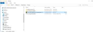

  • Hi Andreas.
    I'm stuck again with the same problem, but this time is even more annoying. Now, when I try to paste the J-Link OB firmware bin file you sent me 10 days ago, the Bootloader folder showing after you get in bootloader mode ¡desappears! I read somewhere that some programs may conflict, so I did exit Dropbox, One Drive, Google Drive and Bitdefender, but no matter what I do including a change in the usb bay being used, the problem remains. Going deeper into the problem I noticed that even if I do nothing, the folder disappears by itself after 30 seconds. If I copy paste the referred bin file faster than this time window limit, then the folder also vanishes and windows explorer ask me to retry>yes> and finally it aborts the paste operation saying that he can not find the folder anymore. I tried more than 30 times though, so please Andreas. For my mental sanity ¿would you please tell me how to get around this annoying problem before I run mad? Thanks a lot.
  • Hi.
    It is normal that the BOOTLOADER folder disappears after around 30 seconds.
     Where did you read this if I can ask?
    Can you try the following:
    1. Find a new USB cable
    2. Put the device in BOOTLOADER mode by holding button IF BOOT/RESET down, and turning power OFF, then turning power ON.
    3. Have the file ready to be dragged into the BOOTLOADER folder like this:
    4. Turn the power OFF, then turn the power ON.
    Does this work? If not, which number on the list does not work?

  • I read It here, Andreas:
    .... There are known issues with this external programmer's bootloader mode, because it mounts what looks like a shared folder. Other applications such as Dropbox or image albums may see the newly mounted shared folder and think that they can do something with its content. Make sure not to select anything and not to close the popups from those applications. That way you should be able to use the folder yourself (as described in step 4 of the list you referred to.)
    Terje
    Up+1DownReply
    kgislason 3 months ago in reply to tesc
    Hi tesc,
    Thanks for your reply. Dropbox was the culprit for the issue, after leaving the window open the mount point stayed and I could flash the JLINK OB software again.
  • Hi.
    I'm glad you got it working.
    Andreas
