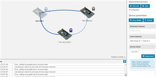

I have tried to run the thread topology monitor. Each attempt ends in this log message "Error - No response from Thread CLI device.".The COM-port has been chosen a  dongle is available in the USB port. The software has been unpacked from nRFTTMwin32x6401201alpha.zip and execute out the unpacked folder.
Please let me know what is missing.

    Could you take a screenshot when the issue happens. What happened after that log appeared ? How often do you see the error ?
  • This is what it looks like
    15:36:49.114
    Error - polling not possible due to incorrect state.
    15:36:51.167
    Link between node (0,0) and node (0,0) has been removed
    15:37:03.116
    15:37:05.163
    15:37:17.113
    15:37:19.200
    15:37:31.109
    As I see it does this restrict my access to the network and because of that the displayed topology is not correct

    I'm sorry for late response. Could you explain how often do you see this error ? It happened on any setup or in particular setup you have ?
    It looks like the dongle was not in any network when the issue occurred.
  • Hi Hung
    This happens all the time. I have one network, i.e. I am doing the verification of this network that is under development. I have one gateway and 7 nodes which all can act as routers. I do not know which of the network elements that is accessed is reported in an incorrect state - more debug information would be very helpful.
    This is what I have in TTM
    All 7 nodes are connected to the GW and transferring information, unfortunately that is not what I see.
