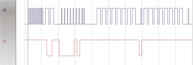

    Yes, I've compared them and the only difference I can see is that the data line never goes low after the command is entered.  I'm using a Parallax part that has a pull-up integrated (only 4.7K) and I've tried the code with both NOPULL and PULLUP on the input (no difference).  Attached is a scope trace that shows the data line not going low.
    So basically the above is clock on top and data on bottom.  There are 9 pulses with data high (reset), a transmit start sequence and then a code word (5 for humidity). the  ack pulse (9th pulse) does not result in the data line going low. so the rest of the data/clock pulses are basically garbage (all ones).

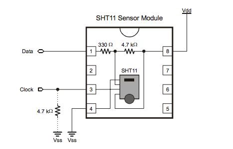

    The wire diagram shows:
    And this setup works great on a Pi + Python without any additional resistors (don't need the clock pull down).  So I think I'm basically clueless as to how the GPIO pins on the 52832 are supposed to work.  The clock pin is set to output all the time but the data pin flips between input and output.  Is there some special configuration I need to get this to work properly (i.e. is there an extra settle delay when flipping between input and output?).

    It is a little bit difficult to read the clock and data lines together, but I think i see the same bit pattern you describe. Would it be possible to upload a plot with higher time resolution to make it easier to see the relative timing of the clock and data edges?
    Your description covers about the first half of the graph, and the rest you say is garbage. But the data line is pulled low at one point there, is done by the nRF (your bit ganging SW)?
  • Hi Einar,
    Here's another capture (maybe better) with some timing ticks
