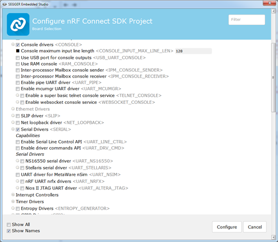

    First, in the secure boot example, go to Build -> Configure nRF Connect SDK Project ... at the bottom. Then, open up Device Drivers -> Serial Drivers -> & uncheck everything related to UART:
    Under console drivers, I would also uncheck "Use UART for console".
    I would then do the same for your application. Then, erase the nRF91 board (nrfjprog -f nrf91 --eraseall), compile both examples & program them to the board.
    Then, you should be able to see lower current consumption.
    We have noticed a few issues with the Project Configuration settings in SES, so if that did not work, I would try disabling UART via menuconfig instead.

  • Ok, I think I may have been a bit hasty in my original response. It was just user error that my serial port wasn't showing up, though definitely I get no output anymore since presumably the UART is disconnected.
    The issue I was seeing with the socket(AF_LTE) call seemingly hanging appears to just be oddities with the step function in the debugger (since I was trying to validate what was going on without serial output)
    One mismatch I am seeing with the instructions is that for the secure bootloader example, the UART items in the config simply don't exist. They do exist in the other application example and I did disable them, but see no change in power usage. Any idea why I am not seeing options to disable the UARTs in the secure_boot example?
