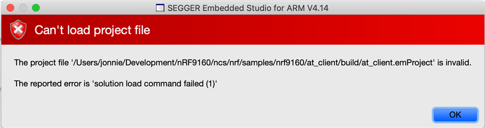

I am trying to do the segger development for the 9160 lte ble gateway.  When I do the setup info for segger I keep getting a popup saying it can't find the .emproject file.  I don't see an emproject file in any of the samples?
  • Hi.
    Which version of Segger are you using? Have you done the nRF Connect Getting Started Assistant?

  • Hi Andreas,
    Yes, I completed the getting started assistant.  I was able to connect to my board and get the "gps" signal and I can flip the switch and see it change status in the RFcloud.  I am using 64-bin Segger v4.14.

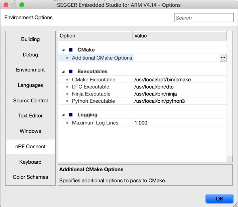

  • Brian,
    Also check that the commands listed in Tools -> Options -> nRF Connect are valid. I also found that the path I had listed for cmake on my setup was invalid. Once this was fixed, the application was able to create a valid project file.
  • Hi again.
    I've replied in the other ticket you are active in, can you please check that. Also I think you only should have to check the options in Tools -> Options -> nRF Connect if you are running MAC.
    Andreas
  • Yes, it fixed the project issue but I didn't yet get past the build issues:

  • Morning.
    After selecting & configuring File -> Open nRF Connect SDK Project, the output of the Segger trying to load the project can be seen in the 'Output' box at the bottom of the screen. This is where I noticed that the cmake command wasn't being found. I then verifiied/fixed the commands in Tools -> Options -> nRF Connect.
    As a result, the project loaded successfully & built.
