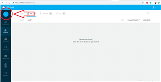

Hi, I am in the initial stages of starting development with nRF9160-DK. At this step, the LED 4 on the board absolutely does not blink. I have tried taking the kit to different places too, for better connectivity but with no luck.
How can I troubleshoot it?

  • So I went back and reactivated the sim card and tried the first step again (LED 3 and 4 both blink) .
    I go to the next step that was the pairing sequence after which LED 4 blinked for a while and turned solid. But I still can not see the kit added as a device.
    According to this article: https://devzone.nordicsemi.com/tutorials/b/getting-started/posts/getting-started-with-nrf9160-dk#h69sjqflk6om1o8mdrn1vfnph47lq1r7
    The kit should be added as a device at this point. Please help me with what could be going wrong.

  • Hi I tried to follow the steps. The log shows this:

  • The log file is attached here. Please observe that log says "Error: At command timed out"
    Please advise on how to troubleshoot this.
    Thanks.log march 11.docx
  • uicr_tcxo.hexMy apologies for this being so difficult. We are aware that there are some issues, and we working with a solution.
    Can you please try to reset the board and see what this does? After this try power cycling the board once.
    Then, if that does not fix the solution, please program the attached file using:
    nrfjprog --program uicr_tcxo.hex --sectorerase -f nrf91 -r --verify
    This file will fix the config of 32 MHz temperature compensated crystal oscillator (TCXO) in UICR.
    After this, try to run the at_client example one more time.
