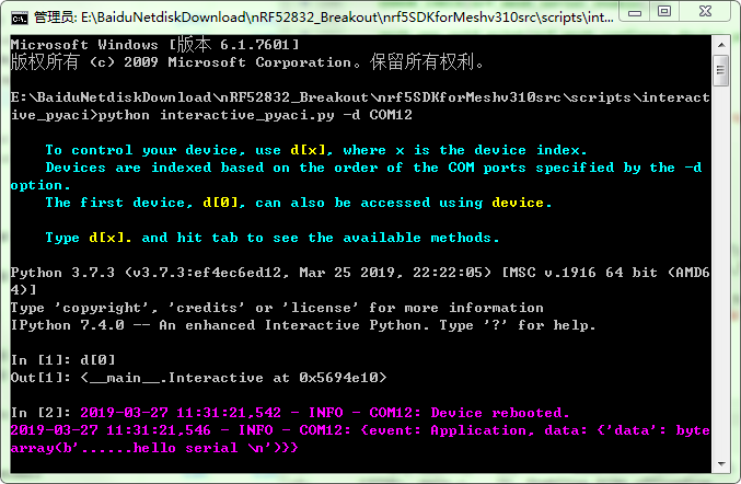

2.I try the python interactive ,it shows below , but it not what i want , i want it send to TX pin ,and in the futrue ,it can connect to anther board:
This devzone case should be helpful in solving this problem, especially the last 3 comments.
