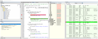

  • Further investigation from my part reveils that in my project, the call to zboss_signal_handler(zb_uint8_t param) for signal ZB_BDB_SIGNAL_DEVICE_REBOOT, the param argument is 0x0B.  The status becomes RET_ERROR.
    While in the example project, the param argument is 0x0A and the status becomes RET_OK.
    Maybe this information helps to give some support from the Nordic engineers ?
    Thanks
    The screenshot below shows my current call stack, cpu registers and coe dissambly

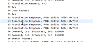

  • Hello
    Thanks for the suggestion, but I'm afraid it doesn't work.
    I have erased the chip with nrfjprog and programmed my project.
    My project and 'eddystone' both running on same zigbee channel (25)
    The 'eddystone' connects with Alexa immediately again.
    My project doesn't connect with Alexa.
    The difference I see in the packet sniffer is that, for the eddystone project, a APS packet is send after the successful association.  While in my project, this packet is never send.  The source of that packet is 0x0000 (this packet is probably coming from Alexa) - The destination is 0x0f2c (probably the address of my development board ?)
    It might be that Alexa rejects the connection from my project for some reason ?
    edit:
    Another difference is that in my project I always get 4x an association response.  While in the eddystone example, there is only 1 association response:
  • Hi
    It seems we have solved the problem.  Our systick timer was using TIMER_1, which is also used by the radio driver.
    I see the APS packets coming and Alexa recognizes our device.
    Thanks for your help anyway.
