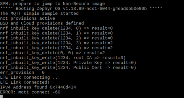

Connecting an nRF9160 to AWS
I'm attempting to connect the nRF9160 DK to our AWS IoT account. I've been following the information in this question: https://devzone.nordicsemi.com/f/nordic-q-a/44528/switch-cloud-endpoint-from-nordic-aws-to-our-own-aws-account but I'm having an issue establishing the connection.
So far I have been able to call the certificates from a replica of 'certificates.h' and flash these onto the nRF91 using the nrf_inbuilt_key commands and have been able to establish a broker connection but receive a time out error when connecting to AWS with MQTT. I am currently modifying mqtt_simple to acheve this connection.

I have added the following additional functions to mqtt_simple:

static int nct_provision(void)
    printk("nct provisions active\n");
    static sec_tag_t sec_tag_list[] = {NRF_CLOUD_SEC_TAG};
    nct.tls_config.peer_verify = 2;
    nct.tls_config.cipher_count = 0;
    nct.tls_config.cipher_list = NULL;
    nct.tls_config.sec_tag_count = ARRAY_SIZE(sec_tag_list);
    nct.tls_config.sec_tag_list = sec_tag_list;
    nct.tls_config.hostname = CONFIG_MQTT_BROKER_HOSTNAME;
    int err;
    printk("BSD and Cloud provisions defined\n");
    /* Delete certificates */
    nrf_sec_tag_t sec_tag = NRF_CLOUD_SEC_TAG;
    for (nrf_key_mgnt_cred_type_t type = 0; type < 5; type++) {
    	err = nrf_inbuilt_key_delete(sec_tag, type);
    	printk("nrf_inbuilt_key_delete(%d, %d) => result=%d\n",
    		sec_tag, type, err);
    err = nrf_inbuilt_key_delete(0,0);
    printk("nrf_inbuilt_key_delete(0, 0) => result=%d\n",
    	err);
    /* Provision CA Certificate. */
    err = nrf_inbuilt_key_write(NRF_CLOUD_SEC_TAG,
    			NRF_KEY_MGMT_CRED_TYPE_CA_CHAIN,
    			NRF_CLOUD_CA_CERTIFICATE,
    			strlen(NRF_CLOUD_CA_CERTIFICATE));
    printk("nrf_inbuilt_key_write(%d, root-CA => result=%d)\n",
    	NRF_CLOUD_SEC_TAG, err);
    if (err) {
    	printk("NRF_CLOUD_CA_CERTIFICATE err: %d", err);
    	return err;
    /* Provision Private Certificate. */
    	NRF_CLOUD_SEC_TAG,
    	NRF_KEY_MGMT_CRED_TYPE_PRIVATE_CERT,
    	NRF_CLOUD_CLIENT_PRIVATE_KEY,
    	strlen(NRF_CLOUD_CLIENT_PRIVATE_KEY));
    	printk("nrf_inbuilt_key_write(%d, Private Key => result=%d)\n",
    if (err) {
    	printk("NRF_CLOUD_CLIENT_PRIVATE_KEY err: %d", err);
    	return err;
    /* Provision Public Certificate. */
    	NRF_CLOUD_SEC_TAG,
    	NRF_KEY_MGMT_CRED_TYPE_PUBLIC_CERT,
    	NRF_CLOUD_CLIENT_PUBLIC_CERTIFICATE,
    	strlen(NRF_CLOUD_CLIENT_PUBLIC_CERTIFICATE));
    	printk("nrf_inbuilt_key_write(%d, Public Cert => result=%d)\n",
    if (err) {
    	printk("NRF_CLOUD_CLIENT_PUBLIC_CERTIFICATE err: %d",
    		err);
    	return err;
    return 0;
void main(void)
	int err;
	int err_provision;
	printk("The MQTT simple sample started\n");
 	err_provision = nct_provision();
	if (err_provision != 0) {
		printk("ERROR: nct_provision failure %d\n", err_provision);
		return;
	printk("err_provision = %d\n", err_provision);
	modem_configure();
	client_init(&client);

I'm not sure what is still left to change in order to make the connection to AWS.
    You are using \r\n as the line ending (normal is \n only), but both shall be accepted by the nrf_inbuilt API.
    I do not see any problems specific to your implementation, but what you could do is to verify that you have the latest modem installed, which can be found here:
    https://www.nordicsemi.com/Products/Low-power-cellular-IoT/nRF9160/Download#infotabs
    Do you always get the same error message, even if you try several times? if you enter debug mode, and debug the function mqtt_transport_socket_tls.c::mqtt_client_tls_connect(), which function returns the err?

  • Apologises for the delayed response. I have identified the issue with the connection. Turns out the network provider requires a whitelisted IP address that is incompatible with the dynamic IPs of AWS IoT Core.
    As the device I am using is deployed in another area of the UK, I can't manually update the modem to the latest version without risking something going wrong. I'd rather avoid updating the modem at this moment if I can get away with it. The device is hooked up to a Raspberry Pi with internet access which can faciliate re-flashing with JLinkExe but hasn't been set up with the modem update tools.
    I've been busy figuring out a counter to this issue and have decided to take a different path and use the BSD library to create a UDP connection to a static IP bounded EC2 instance on AWS. I have encountered a different problem with setting up this kind of connection however.
    The code compiles but the nRF9160 reports back a hard fault when the code is loaded onto the device. It will run the code until the UDP IPv4 socket information structure (struct nrf_sockaddr_in) is populated. I've tried to follow what examples I have found of this structure in the ncs repo but I seem to be missing something.
    This is were it appears the code gets to before hard fault, I placed printks to figure out where the code reaches before faulting:
