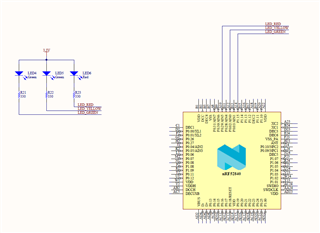

Hi Everyone,
I have a custom board with nRF52840 and am testing out basic GPIO functionalities with some LEDs. In the board, the LED cathode is connected to nRF52840 GPIO and the anode is connected to 3.3V; so, I need to pull the GPIO to LOW to switch on an LED and pull the GPIO to HIGH to switch off an LED.
The GPIOs that I'm using nRF52840 can output logic HIGH and LOW; however, the logic level for LOW is at 1.76 V (or 1.44 V) which doesn't make sense to me - logic level for HIGH is okay at 3.3V. As a result of having LOW at 1.76V instead of 0V, the LEDs are dimmer than they are supposed to be. On a few occasions when I uploaded misconfigured firmware, I've seen the LEDs blink at their expected brightness, but I can't tell what's going wrong here.
I've tested the same code on nRF52840DK and the output seems to be fine: the GPIOs on nRF52840 output 0V and 3.3V for LOW and HIGH, respectively. I'm not sure what's going wrong on the custom board, however; the connections are fairly straightforward.
I'm running the code using Segger Embedded Studio. The SWD on nRF52840DK is used to flash the custom board as it does not contain an on-board debugger.

Here's the schematics for the connections used.
  • What drive strength do you have configured on the pins? If you left them at standard drive that's 0.5mA. At a guess the LEDs drop about 1.5v depending a lot on the LED you've used. At 0.5mA the resistor would drop 0.15v leaving (3.3 - 1.5 - 0.15) = 1.65v which the pin current limiting resistor would drop so the pin would be about 1.65v, not too far from what you're seeing. If you set the pins to high drive, which is 5mA (note there's a limit to how many pins you can do that with) you should see very close to 0v on the pin.

    After reading your reply and digging up drive strength (here and here), it appears the drive strength was causing the problem since it was left to the default configuration value NRF_GPIO_PIN_S0S1. The LEDs are drawing 20 mA current at Vf = 2V which is above the total 15 mA sinking limit. I guess I'll have to change the LEDs in the next revision.
