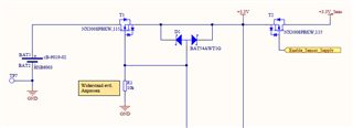

I need to measure battery on my nrf52 beacon. My input voltage is 4*AA batteries(each 1.2V so in total 4.8V). The schematic provided by the hardware developer is as follows
Now I read few posts about battery measurements and looks like I need to add some additional hardware? Kindly tell me whether its possible to measure voltage using existing hardware, if so please describe, the calculations or at least point me to the right direction.

  • I read few posts about battery measurements and looks like I need to add some additional hardware
    Yes - that should be clear from those posts!
    Surely, this is something that your hardware developer should be doing? It is a hardware question!
  • I think it involves both, hardware and software. As far as I know , there must be some kind of voltage regulator used to bring down voltage to 3V. Can we use that to do our battery measurements?

    The measurement from my voltage divider is feeded to AIN7 but it measures 0.9V on the battery while my input is 5.2V and 0.7V when my input 4.5V. Can you suggest what am doing wrong in here
    Can you try using the internal reference instead of VDD? I would expect that to be more stable, even though you must have a regulator in your power supply circuit since the battery power is too high.
    Then there is also the point that depending on your circuitry and battery etc the voltage will probably drop a bit when you do ADC sampling compared to when you measure on the battery when the nRF does not draw much current (if that is what you are ding). Therefor you should have a capacitor in the circuit as well, as described here.
    Depending on what I have mentioned above, your result might not be that far from expected.
    The voltage out of the voltage divider in your case is 5.2 V / (470+110)*110 = 0.986 V.

  • Yes, my measurements are close to what you said, now we need to map our voltage divider measurement to input voltage?
  • Yes. After all, you are not measuring the supply voltage directly, only the voltage over one of the resistors in the voltage decider. You need to calculate the input voltage to the voltage divider. You can do it this way:
    Vin = ((Vout)*(R1+R2))/R2
