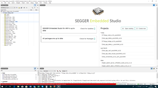

I tried to program the Thingy52 with the node and bridge to set a Mesh and I got the message in red you can see at the attached.
Please advise.
Thanks
Please advise.
Thanks
Hi Josh,
The example you are using is pretty old. We suggest you to try with this demo instead.

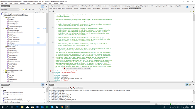

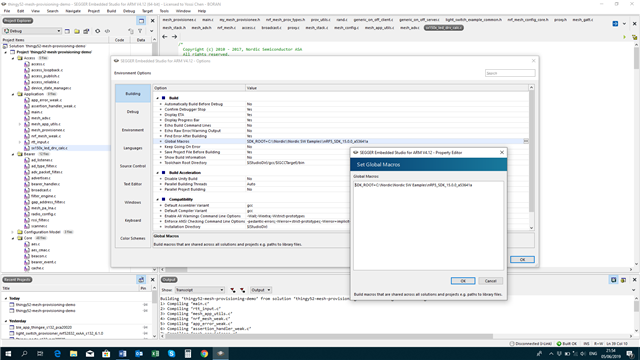

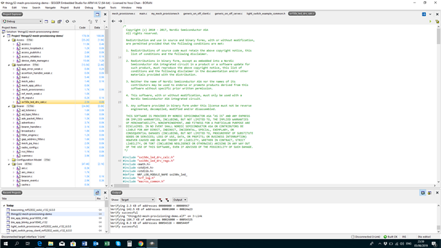

Hi
O.K , I followed the Thingy Mesh Provisioning Demo v0.5 instruction
https://github.com/NordicPlayground/thingy52-mesh-provisioning-demo
But I got the message "no such file or directory" when I tried to program the software ,see at the attached screen shot .
Please advise.
Thanks

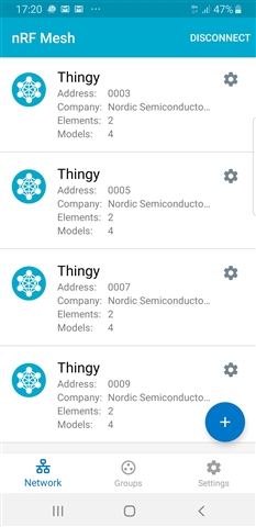

Thanks Hung!
I succeed to flash the firmware after erasing all.

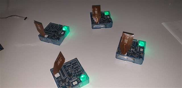

you can see the attached 2 pictures one is for the nRF Mesh app and the second is the Thingy 52 (Four units) which are "Breathing Green: Thingy is provisioned but has not been configured"
I don`t understand how to configure from nRF Mesh app the Thingy 52 to be Light or Switch like show at the video demo "https://www.youtube.com/watch?v=XthbU9NP0Yg"
Please advise
Thanks
You would need to do cònfiguration. First you connect to one thingy. Then you click on the gear icon and select configuration ( I think) then you should be able to add the app key, bound app key to a model, choose the publication address, subscription address.
Please refer to the configuration in the video clip.
You can follow this to know more on how to do provisioning&Configuration using the nRF Mesh app: infocenter.nordicsemi.com/.../md_examples_light_switch_README.html
Hi
Unfortunately , my Android nRF Mesh app is different from what showing in the video clip and I can not successful with configuration.
Do you have any idea how I can solved this issue? I am stuck!

From the pictures above you can see that I already provisoned with the nRF Mesh app all the Thingy52
I just do not no how to configure them as server and client like done at Nordic demo because the nRF Mesh app there look different from the nRF Mesh i have , why it is need to be different and how i am do it with my latest nRF Mesh app.
