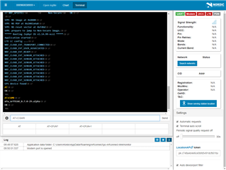

    If I connet the Link Monitor and reset the device, it seems it is more difficult to connect and the system do some trials after it gives the nrff_cloud_connect failed: -111 error. Here the screenshot of the Link Monitor

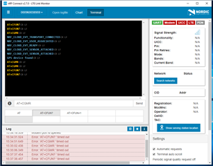

    I could connect once but when I followd the association pattern it didn't do anything. Here the screenshot of the Link Monitor.

    I don't know how to check the firmware becasue I have no answer to the AT commands

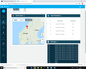

    Sorry, althoug now is associated the GPS information shown in my cloud says that I am in Norway. Moreover the AT commends continue wihout working
  • Have you made any changes to the FW application at all? I am not exactly sure which version of the asset tracker code is running on the nRF91 when it is shipped out. It may be that that FW does not support AT commands. If you want to test with NCS tagged version 0.4.0, I have uploaded a merged hex file which includes the Secure Partition Manager code along with the Asset Tracker application. This FW does support AT commands.
    merged.hex
    You can program the nRF91 via the following command (make sure the switch is in the nRF91 position):
    nrfjprog --program merged.hex -f nrf91 --sectorerase --verify
    The code shows simulated GPS data at the moment because the modem FW is not currently optimized for timeslotting LTE with GPS. This will be fixed in a future modem release. That is why the position is in Trondheim, Norway.

    AT commands are working now and this is the modem firmware version
