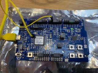

  • You're correct. The chip is simply not entering system off mode as LED 4 is turned on in gpio_init() and then never turns off. This makes me think that when I un-ground PIN 16 the event handler is not being fired. I have changed the code to now include sd_power_system_off() though although we are not getting to this point in the code.
    The sequence of events that I see are:
    • Flash the device with 16 physically tied to GND
    • LED 1 flashes once to indicate fast advertising (not sure why it only flashes once and stops)
    • LED 4 then turns on indicating that gpis_init() is running.
    • I then unplug ground which should allow pin 16 to rise up to high and trigger the in_pin handler, but and LED 4 stays on indicating that the code below in in_pin_handler() is not run.

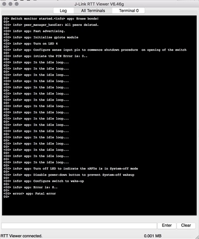

    I've made lots of progress and have it effectively running GPIO_init() and going to the in_pin_handler()  which I did by removing in gpio_init() the following code
        //err_code = nrf_drv_gpiote_in_uninit(SWITCH_PIN);
        //NRF_LOG_INFO("Error is: %d..", err_code);
        //APP_ERROR_CHECK(err_code);
    and in in_pin_handler() the following code
    				//Disable power-down button to prevent System-off wakeup
                    //NRF_LOG_INFO("Disable power-down button to prevent System-off wakeup");
    		        //nrf_drv_gpiote_in_uninit(SWITCH_PIN);
    My log now looks like this
    So gpio_init is being called and the in_pin_handler() is being called but the error is in the in_pin_handler() at this line
    err_code = nrf_drv_gpiote_in_init(SWITCH_PIN, &in_config, NULL);            	 //Initialize the wake-up pin
    Error code 8 usually means that something has been declared before?
    Oops.. thought I better add my development stack
    I'm using
    • An nRF52832 DK
    • SDK 15.3.0
    • Segger IDE
    • The soft device is S112
    • JLinkRTTViewer for debug
    Any help on this fatal error 8 gratefully received.

  • Yes, error 8 (INVALID_STATE) means that either the driver is not initialized, or the pin is in use. I see that you removed nrf_drv_gpiote_in_uninit() on SWITCH_PIN in in_pin_handler, so the pin will be in use when you try to init it again below. Note that you can also configure the sense functionality of a GPIO for wakeup directly using the GPIO HAL function nrf_gpio_cfg_sense_input().
