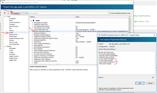

    What I was confused of was the definitions for the RAM and flash size parameters in SES when converting from PCA10040 to nRF52810 (BL651). Would you be able to provide a more in depth configuration procedure, maybe I have a missing step?
    If you are only adapting an existing example to a different chip, then the only linker related change is to adjust FLASH_SIZE and RAM_SIZE to reflect the new sizes (the sum of start address and size must not be larger than the physical flash). (If you are using a bootloader etc. that complicates a bit since you need to make room for that as well). See the image below for wher you configure this in SES.

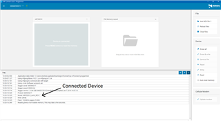

    Thank you for the quick response. Using the command you proposed I was able to retrieve the different device IDs of the 2 custom board I soldered. The issue was that I was using the wrong set of commands to validate the connections. The respective result is show below, where A01CA2C3 ... is from the dev kit, where as the other 2 are the custom boards.
    So from the point of connecting to the modules I am assuming it was successful since I obtained 3 different IDs. As such the remaining point which I need to revisit is why it is not successfully program, and from the last point you mentioned that I would need to take care of any internal boot-loader, where the BL651 modules do not advert any form of pre-configured loader.
    As you suggested, if I do not manage I will create a new thread for that and mark this as answered.
