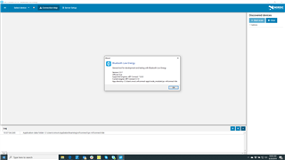

Simon,
Thanks for your response! Here is the current nRFConnect, which I have. I think it is up to date. I am really looking to use the nRF Conenct for Desktop app with the 2M and coded PHY, like you can with the nRF Connect on some Android phones. Is this possible with the nRF Connect Desktop app?

Hi Vincent
The Desktop app does not work as a BLE central/peripheral by itself, and you'll have to connect an nRF device to the computer (like the 52840 Dongle or a DK for example) in order to use the nRFConnect app like this. You'll have to program the BLE device to operate in the intended PHY. Please check out our Long Range Demo for more info on Coded PHY. Please note that the Dongle antenna is not very well suited for operation in Coded PHY, and you can't expect the same ranged that is achieved with the nRF52840 DK in the long range demo.
