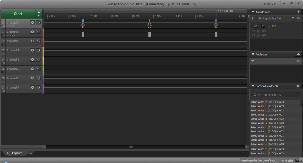

I am writing drivers by myself & stuck in the first step of I2C DETECT not happening.
SDK: nRF5_SDK_15.2.0_9412b96\examples\peripheral\twi_scanner
MCP7940 Break-out: https://rheingoldheavy.com/product/breakout-board-mcp7940/ which works perfectly with Arduino at I2C Address: 0x6F

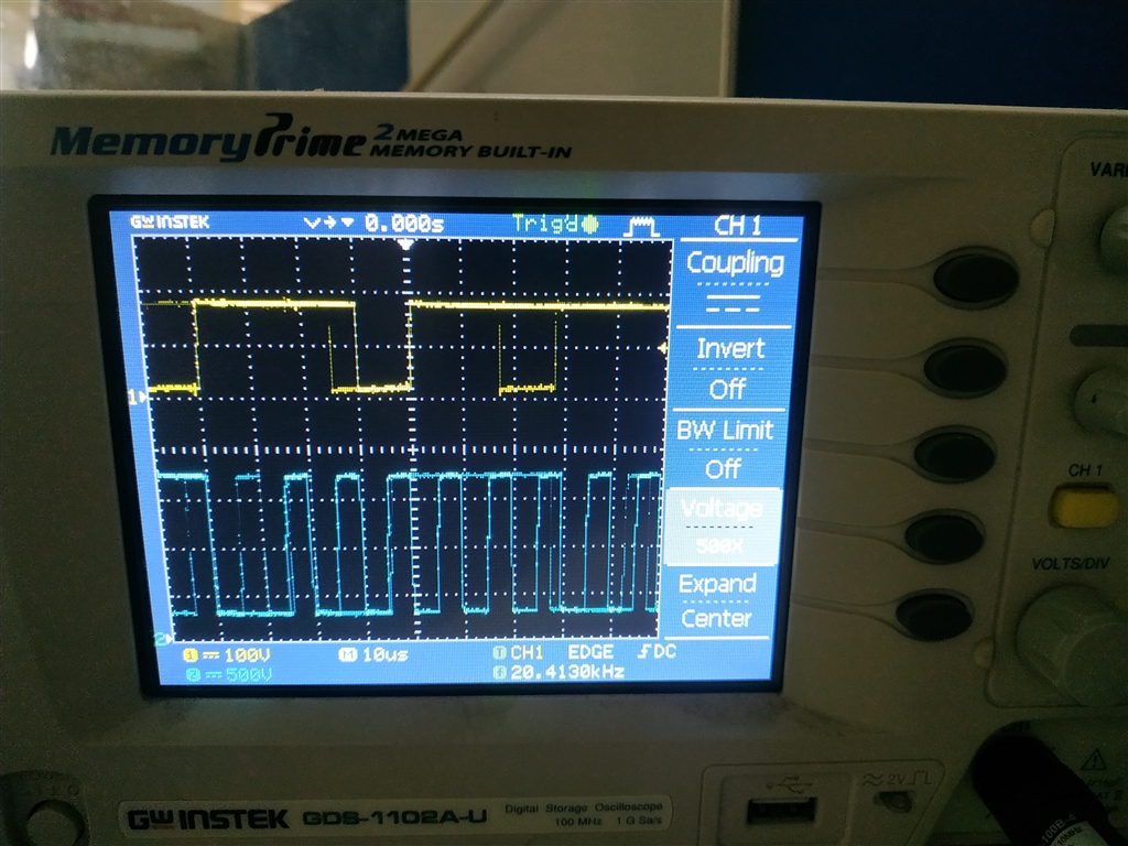

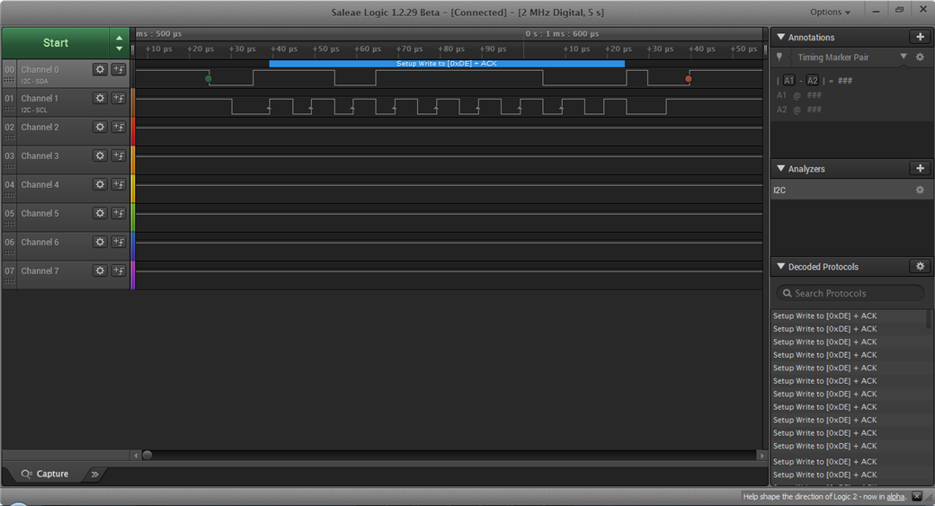

But I2C DETECT not working with nrf52840 DK. Please suggest how to debug this issue? We have an Oscilloscope!

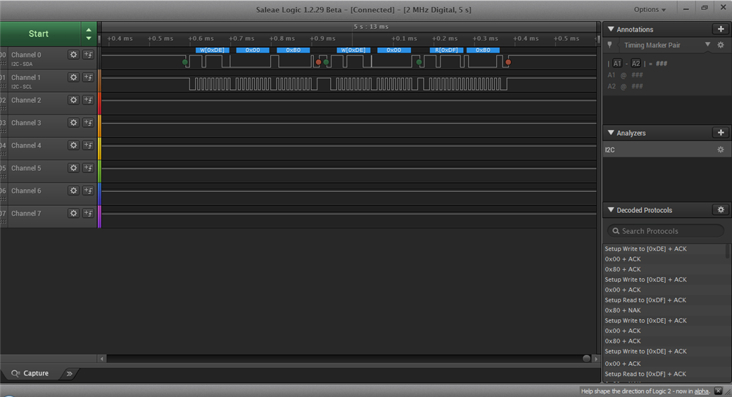

If you want to start the oscillator, then you need to set bit 7 in REG_RTCSEC to 1, i.e. you need to write 0x80 not 0x07.
The read operation is Not Acknowledged so it could be that you have to select the register you want to read from before

Please check still NAK

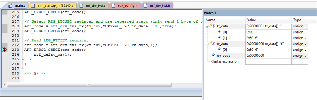

Yes, but you are reading back the value of the register, i.e. 0x07. Wasnt that what you wrote to the register previously? What is the return code of nrf_drv_twi_rx()? Is it NRF_ERROR_DRV_TWI_ERR_DNACK or NRF_ERROR_DRV_TWI_ERR_ANACK?
err_code = 0
Ok, if the nrf_drv_twi_rx call does not return a non-zero error code, then things are working as they should. Could you try to run the following code and see if the rx_data[0] is 0x80. If it is then the code is working as intended.

Yes getting 0x80

}MCP7940.h
Great, then you are good to go. You should be able to reuse the snippet I provided to configure the MCP7940. My suggestion would be to capture a trace of the Arduino Init sequence to see which values that are written to which register and then just copy paste the code snippet I provided and change the REG_RTCSEC register value and the 0x80 to match what you're seeing in the trace.
