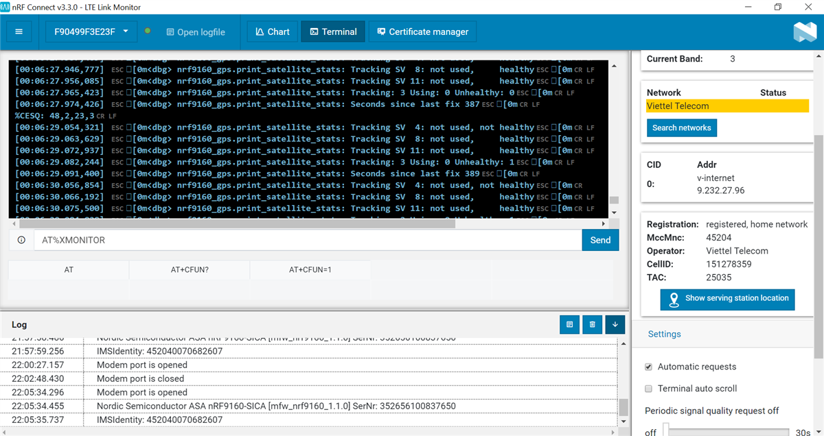

I am doing some test on the Thingy:91 v1.0.0 in Vietnam. I am running 2 examples: Asset Tracker with NB-IoT + GPS and GPS.
When I use the stanalone GPS example, I can get the fixed GPS. However, when I run the Asset Tracker I cannot get the fixed GPS.  When I hold the button of the board to turn to GPS mode, it also cannot get the fixed GPS.
I am using the master branch, module firmware v1.1.0 and nrf9160_pca20035ns.
I attached to log results with this post, could you help analyzing the root cause and giving me some hints to fix it? I really appreciate that.

  • Hi Duy,
    Please get in contact with Viettel Telecom with regards to if they support PSM mode or eDRX intervals for NB-IoT.
    In the asset_tracker sample, you are running the Modem on the NB-IoT network, where it tries to go into PSM mode to be able to turn on the GPS. If the network does not support PSM mode, then you won' be able to run it from default.

  • Hello Martin,
    Sorry for my late reply, Viettel Telecom don't support PSM.
    Do I need to modify anything to make it run with eDRX? Or at least to make it run GPS and NB-IoT at the same time without PSM.

  • Hi Duy,
    If Viettel Telecom does not support PSM mode, it is also possible that they do not support the eDRX feature in RRC IDLE mode.
    The nrf91 cannot run GPS and NB-IoT communication concurrently. The GPS can only be used when the modem is not being used by the LTE network.
    So you can use the GPS when the LTE is in PSM mode or in between the eDRX intervals.
    First, let us check if the network supports eDRX intervals by sending some AT commands where you request eDRX intervals.
    Please flash this app: thingy91_at_client_v0.2.3.hex
    Send the following commands:
    at+cfun=4
    at%xsystemmode=0,1,0,0
    at%XEPCO=0
    at+cfun=1
    #wait 2 minutes
    AT+CEDRXS=2,5,"1000"
    You should get a response from the network if it will provide you with that interval.
    Martin L.
  • Hi Martin,
    Thank you for your reply. I runs the commands like you shows, I got "OK" returned when running AT+CEDRXS=2,5,"1000".
    Then I used AT+CEDRXS? to check again and got +CEDRXS: 5,"0010".
    I also attached the log file.

    2019-12-11T03:08:53.144Z DEBUG modem >> AT+CEDRXS=2,5,"1000"\x0D\x0A
    2019-12-11T03:08:53.149Z DEBUG modem << OK\x0D
    2019-12-11T03:09:12.077Z DEBUG modem >> AT+CEDRXS?\x0D\x0A
    2019-12-11T03:09:12.082Z DEBUG modem << +CEDRXS: 5,"0010"\x0D
    2019-12-11T03:09:12.083Z DEBUG modem << OK\x0D\x0A\x00

  • Hi Duy,
    Let's take a look at two examples on how to set and read the eDRX values from one network that support it and for one that does not.
    [Network supports the eDRX feature]:
    So the first example we request the eDRX value "1000" from a network that supports this feature:
    [Network does not support eDRX feature]:
    The second example is on another network, but the same eDRX interval request:
    From what I can see from your log, it looks like your network does not support this feature as of now.
    Please get in contact with them for more details.
    Martin L.
