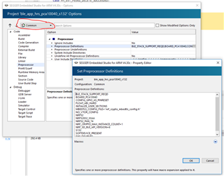

      I faced was as guided in the dongle programming tutorial, I can't see any preprocessor definitions rather the it says "inherit" and when I click three dots besides it, I find the text box complete empty and nothing over there. Do I need to write all of the stuff shown in the tutorial by myself or it appears by itself and I just need to remove the PCA10056 and replace it with PCA10059. If so, why my preprocessor definitions seems empty. same is case with the linker option it says "inherit" and the text box for linker is empty. Please provide an explanation for this.
    The reason you only see "inherit" is that you have not selected the common configuration. "Release" and "Debug" both inherit from "Common", and that is where you should do your changes. Please see this screenshot:
    Also in a thread I read, I need to explicitly undefine the board I'm not using(in this case it would be PCA10056). Link https://devzone.nordicsemi.com/f/nordic-q-a/43760/adapting-the-blinky-example-from-the-nrf52840-dk-to-the-nrf52840-dongle/171455#171455. Do you confirm this?
    No. There is no need to undefine the other board, just remove the definition in the first place, and add the correct one for the dongle.

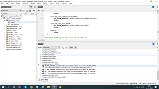

  • I changed the setting to common and then I right click on the project and hit build. I am using ble_app_uart example now. it gave me couple of errors. I am attaching a screenshot of the same. what am I missing now? is uart example not meant to be used with dongle? if so what is the alternate example which would serve the purpose of uart example
    You get the error because RX_PIN_NUMBER, TX_PIN_NUMBER, CTS_PIN_NUMBER and RTS_PIN_NUMBER are undefined. If you refer to components\boards\pca10056.h you will see that it is defined there (for the nRF52840 DK), which is because they are connected to the UART-USB bridge. The nRF52840 Dongle does not have a UART-USB bridge, and that is probably why they are not defined. So in order to use UART with the dongle, you just need to decide which pins you are using for UART, and add these defines to components\boards\pca10059.h with the correct pin numbers. Then you need to connect these pins to your UART device (for instance an external UART-USB bridge if connecting to a PC).
