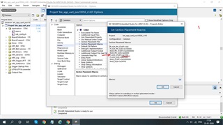

  • Sorry, I got bit lil busy with other projects but I followed all those steps and got it to the point where I need to upload the program to my chip and I got a Waring of overlapping memory locations. I have attached the screenshots of the same. Is it safe to proceed like this? or have done something wrong? Awaiting your kind reply eagerly
    I see your application starts at 0x1000. This is correct for examples that do not use the SoftDevice since that places the application immediately after the MBR. However, since your application uses the SoftDevice, it should be located immediately after the SoftDevice. If you are adapting an existing example that uses the SoftDevice, that means you should not change the address, since it is already correct. Alternatively, you can check the SoftDevice specification for your exact SoftDevice version, and see the size. The start address of the application is equal to the size of the SoftDevice (including MBR).
  • Hello! thanks for reply!
    I am using s140 softdevice the same which I used while I was burning blinky_app and now I am using ble_app_uart from ble peripheral. Am I going correct I'm using SDK version 15.2.0. I havent changed any memory locations by myself I kept them as it is and just followed the instructions given by you earlier posts. what else do I need to do?
    It is not entirely clear to me what exactly you have done. The nRF52840 Dongle Programming Tutorial explains all the steps in detail, so basically you should follow that.
    As mentioned, it looks to me like you have set the application start address wrong. Can you confirm that it is set to the size of the SoftDevice? Alternatively, can you just show the memory configuration for your project? You find it here:
    Since you are adapting a project that uses a SoftDevice you should just keep these settings as is. In other words, with S140 version 6.1.0, FLASH_START for the application should always be 0x26000.

    Now I am trying to upload ble_app_uart example and I am using S140 softdevice. I have made changes in Preprocessor definitions and linker configuration as mentioned in the tutorial. I changed RX tx and two other pins in boards.hex file of PCA100059 as you advised me in earlier post. Apart from these changes I haven't made any changes to the entire coed or its configuration in any sense.
    I followed the tutorial:
    https://devzone.nordicsemi.com/nordic/short-range-guides/b/getting-started/posts/nrf52840-dongle-programming-tutorial
    and it says I have to edit some definitions in linker as:
    Adjust the linker configuration. Set FLASH_START=0x1000 to place the application right above the MBR. You should also set FLASH_SIZE=0xDF000 to make sure that there is room for the bootloader at the end of the flash. Set RAM_START=0x20000008, as the first 8 bytes are used by the MBR for interrupt forwarding and adjust the size accordingly by setting RAM_SIZE=0x3FFF8.
    I did the same as it says in the tutorial.
    Besides
    Do I need to make any other changes that differ from the ones that are prescribed in the tutorial mentioned above? If so please let me know in detail.
