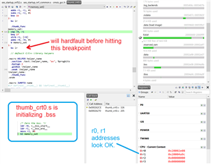

When we do this, our application does not startup up at all, and the SES Debugger shows us at address 0x00000000 ... see attached picture below [Crash.png]
Note also the messaging indicating: T-bit of XPSR is 0 but should be 1. Changed to 1.
To further isolate the problem, I commented out NVIC_SetPriority(DebugMonitor_IRQn, _PRIO_SD_LOW); ... but no change...
Very weird ... [DebugMon_Handler] is being compiled in, but not being executed.
... and all of this causes the SES to fail in loading the application. I am a bit stymied.
I tried setting early breakpoints in thumb_crt0.s ... but it would not hit any of the early breakpoints.
