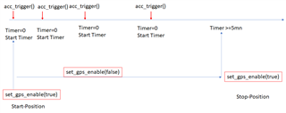

Im trying to use the motion to activate the GPS and deactivate GPS:
    1. when it moves, GPS will be activated: Position-ON
   2. when it stops, GPS will be activated again: Position-OFF
Currently, I used the sensor_trigger_set() to enable GPS when it detects the motion as in :https://github.com/NordicPlayground/fw-nrfconnect-nrf/tree/master/applications/asset_tracker
But, I dont know how to implement the step 2:  when it stops, GPS will be activated again: Position-OFF
Could you plz help me, thanks so much

    I want to start GPS again. For example, my thingy:91 is staying in my car, when the car is moving: start GPS and capture the start-Position, then stop GPS. When the car stops, start GPS again, and capture the stop-Position. During the moving time of the car, the THINGY:91 will sleep (to save the power), it just captures 2 positions: start and stop position.
    How do you define the "STOP" position? Is it to be detected based on a sensor event, or a timeout event? How to distinguish a stop at a traffic light vs. an actual stop?
    One way of doing this can be: if you store the time since last registered movement, then start the GPS a given amount of time after the last movement was detected.

  • How do you define the "STOP" position? Is it to be detected based on a sensor event, or a timeout event? How to distinguish a stop at a traffic light vs. an actual stop?
    I tried to use the timeout event, for example in 1mn, if no motion --> actual stop
    Ja,  I will try this one Smiley

  • Hi ,
    I tried:
    1. accelerate trigger will :
           1.1. Reset the timer: Timer
           1.2. Start the timer: Timer
    2. If the Timer > 5mn (no motion in 5mn) -->Stop --> enable GPS to find Stop-Position
    So, I need a function for the timer , and i found :
     https://devzone.nordicsemi.com/f/nordic-q-a/59950/timers-in-nrf9160-soc/244049#244049
    And, i modified the timer_cb() to test:
    void timer_cb(nrf_timer_event_t event_type, void * p_context) {
        printk("start GPS ..\n");
        gps_control_init(&application_work_q, gps_trigger_handler);
        printk("set_gps_enable----------\r");
        set_gps_enable(true);
    i want i can start the GPS, but I got the error:

    How can I use the timer to start the GPS?
    Do you have any suggestions?
    Thanks so much
