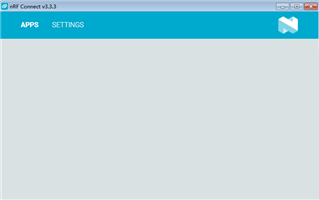

After installing nrfconnect, what can be done to appear in the app normally?

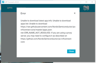

It's likely that there's a problem with the network
Hi Amanda Hsieh,
1.I confirm that it is a network problem,
2. It has nothing to do with the computer or the operating system,
3. Is there a way not to connect to the network to update the app?

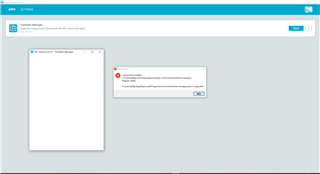

1. I tried to install locally, the installation times wrong.
2. Open the program times error as follows.
3. Try the local installation Times error as follows.

Thank you very much, this problem has been solved.
1. Find this directory on a computer that has completed nRF Connect software: %USERPROFILE%.nrfconnect-apps
2. Override this directory on a computer that does not display a list of apps: %USERPROFILE %.nrfconnect-apps
3. The unusual problem with nRF Connect that does not display the app directory is resolved.
