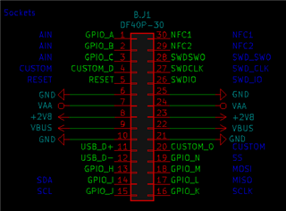

On the north of the board there are the two Hirose DF40 connectors. Placed on the top and on the bottom sides and linked each other, they're used to attach series of similar boards into a deck and act like a bus. Here is the pinout:
First concern is the NFC. The NFC traces are routed to the pins 29 and 30. Main idea about them is to have a dedicated board for the antenna. It was also planned to put tuning capacitors to the antenna board too. Unfortunately, the traces are walking over SWD traces, in particular SWDCLK and SWDIO. Passing NFC from board to board is also not the best idea either. But what do you think?
Another question is about the pins 40 to 43. Accordingly to the board design the pins must be reserved for SPI. But per section 4.3 GPIO Usage Restrictions they must be low frequency I/O. The nRF52832 doesn't support high-speed SPI, but should I be concerned about using the pins for 8MHz SPI?
Generally speaking, I'm not too happy about the "beard" from those vias around the DF40 - just trying to avoid HDI and keep fabrication cost low. Maybe there is something that I've missed about the connectors, and which terribly breaks the design?

    NFC: Passing to another board should not be a problem. Passing the traces over the SWD traces might not be optimal, but hard to say. If you want to be on the safe side you should separate them with ground in the internal layer(s).
    High-frequency IOs: High drive IOs and frequency >100kHz should be avoided during radio activity, some radio performance parametres can be affected.
    The connector I guess is what it is, but should not be too critical with regards to any performance from what I can see. Maybe it will be easier to get a more tidy design ig you move it slightly or extend the board slightly towards the north so that you can partly approach it from the other side?

    Regarding the NFC and the high-freq IO: thanks for the advice! I'll try to move SPI to different pins, and also route SWD on the third plane. The SWD will collide with VDD in this case, but on the whole it might be better.
    The connector: it has to be fully transit for every such a board, hence the vias. Also, can't place many vias in between the connector legs :(

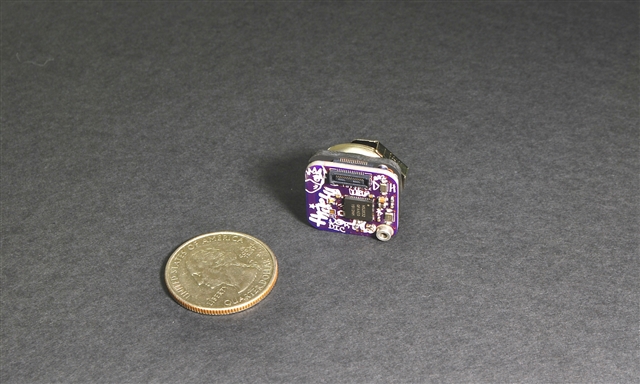

    it was a while since my last message in this thread. For that period I've assembled and tested the prototype - thanks for your support! Unfortunately (and to be honest it was expected), the mechanical stability of the prototype assembly is far from perfect. The DF40 connector can't hold the boards firmly, and the single one standoff is not enough to compensate for that.
    Also, while designing other boards where the module should go, I've figured out the number of signal lines in the socket should be increased. A 40-pins connector would allow to increase it up to 28 I/O thus cover most of the needs, while other 12 pins could be dedicated to ground and four power rails, including battery and VBUS
    Such, the PCB has got complete redesign. The board form-factor is now very close to the TinyDuino which I've discovered shortly after ordering the prototypes (whoa! wish I'd know it before). It has four mounting holes of smaller size. However, the holes make it impossible to fit a PCB trace antenna into the board. To address this the board has got ultra-small Johanson 2450AT07A0100 mid-plane chip antenna, but I'm not quite happy how the waveguide is routed. I'd appreciate if you could take a look at it, please.
    Another concern is the signal routing. To fit the antenna I've turned the nRF52832 by 90º and many signal lines got crossed, notably, the NFC. To prevent crosstalks there is the solid ground on the second layer, while most of the routing is on the top and 3rd layers.
    Also, the design assumes all the boards in the series to have the same interface, so I've put SPI on the pins 20, 22, 23, and 27 of the nRF52832, and the very last one pin may be a no no. Since there's not too much space for maneuvers the backup plan is to drop the SWD SWO support and assign one of SPI pins to the leg 21 / P0.18. Of course, your notes on this (and not only) will be highly appreciated!
    I've attached new gerbers and PDF scheme to this message (thirtytwo-20201224.zip)
