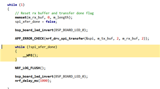

    while (1)
        // Reset rx buffer and transfer done flag
        memset(m_rx_buf, 0, m_length);
        spi_xfer_done = false;
        bsp_board_led_invert(BSP_BOARD_LED_0);
        APP_ERROR_CHECK(nrf_drv_spi_transfer(&spi, m_tx_buf, 2, m_rx_buf, 2));
        while (!spi_xfer_done)
            __WFE();
        NRF_LOG_FLUSH();
        nrf_delay_ms(1000);

The code compiles successfully with no error. When I debug, the control gets stuck in the highlighted function below.

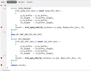

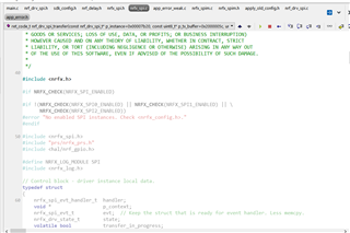

, the NRFX_SPI_ENABLED is enabled in sdk_config, but it still appears grayed out, as below

1. in main.c
2. nrf_drv_spi.c, the highlighted code gets executed.
3. as the nrfx_spi_xfer is grayed out as below,
The control shows result as 0 at step 2 and gets stuff at the while loop.

    The fact that your nrfx_spi defines are grayed out indicated that they are not defined, and thus not visible to the preprocessor.
    Most likely, this is caused by having unused defines in your sdk_config file - I recommend that you do not set *_ENABLED to 0 in the SDK config, because this will still leave them as defined, even though they are set to 0.
    For more information about this, please see this and this ticket. In essence, leaving the *_ENABLED defined to 0 will still make the apply_old override the nrfx driver.
    So, could you try to comment out or remove the legacy spi *_ENABLED 0 defines from your sdk_config, and see if this resolves your issue?

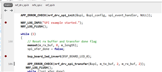

  • Thank you, the greyed out area problem is resolved. But the spi_event handler doesnt execute.
    Debugging flow
    1. nrf_drv_spi_transfer function call

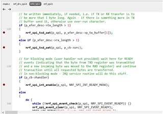

    2. from nrf_drv_spi_transfer , nrfx_spi_xfer is called from
    3. from nrfx_spi_xfer, the spi_xfer is called
    4 nrf_spi_int_enable is called from  the spi_xfer
    And they start reverting the function values back,(backtrack the above path.) and finally return 0.

    Could you configure DEBUG is SES, so that you may see any errors that are called?
    I suspect that the 0 you are seeing being returned is in fact the NRF_SUCCESS, indicating your call to spi_transfer was successful.
    Furthermore, what are you seeing on your sensor side of things - does the sensor indicate in any way that communication is happening ( such as a LED blinking ) ?
    What is the output of your logs when your code is running?

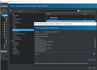

    Great! Could you confirm for me that the "DEBUG" is included in the "Preprocessor definitions"?
    It is not enough to just select "debug" instead of "release" configuration.
    If DEBUG is defined in SES then you should be able to see where an error was generated.
