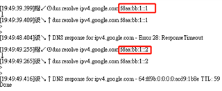

  • Hi Jørgen:

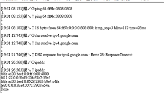

    1. I try to do the DNS resolve command from the CLI, to check if you are able to get the IP from thethings.IO cloud solution, but it fails too.
    it is somehow blocked?
    Pls kindly help advise how to solve it?
    2. I need your help for me, assistance to double-check, My IP address support IPv4 or IPv6??
    3. I need your help for me, assistance to double-check, My Border Router can support IPv6 assign global IPv6 to the device?
    4. If I want to use CoAP sned get resource data of thething.io server from example thethings_io_coap, how I can modify it?
    I want to timer get resource data.
    Best Regards,
    Rick.
  • Hi Rick,
    1. Yes, it looks like there is something blocking you from reaching the address. Can you try to ping it (coap.thethings.io) from a computer in the same network?
    2. Since you are able to ping the 64:ff9b::0808:0808 address, you have IPv4 connectivity. You do not have global IPv6 connectivity, since you do not get a 200x:: address on the end nodes. This is either caused by the ISP not providing IPv6 address with large enough scope to allow subnetting to the required Thread /64 prefix, or the network equipment/router is preventing you from getting the correct prefix on the border router (you can see that the wlan0 from your ifconfig shows that you have a global address with /64 prefix, this needs to be /62 or lower to allow IPv6 connectivity to the Thread nodes).
    3. This is not something we can help you with. You need to check in your router/modem if you are assigned a large enough scope from your ISP, or you need to check with the manufacturer of the network equipment how you can configure it to assign larger prefix address to the border router.
    Jørgen

    1. I go to try to ping it (coap.thethings.io) from my computer and Raspberry Pi, it is successfully.
    What next step should do?

  • Hi Rick,
    1. That is strange. Could be that the DNS is not able to resolve the address then. Are you able to resolve other addresses from the Thread CLI, for instance:
    dns resolve ipv4.google.com fdaa:bb:1::2
    2. We do not have any examples showing that, but you need to at least change the type from OT_COAP_CODE_POST to OT_COAP_CODE_GET in the otCoapMessageInit() call. I also believe that the resource name should be added to the CLOUD_URI_PATH. Further, I believe that the calls to otCoapMessageAppendContentFormatOption(), otCoapMessageSetPayloadMarker(), and otMessageAppend() can be removed. You also need to pass a response handler to the 4th parameter of the call to otCoapSendRequest(), which is where you will get the data when you receive the response from the cloud.
    Jørgen
  • Hi Jørgen,
    Thank you for your reply.
    1. I use "fdaa:bb:1::2", can resolve other addresses from the Thread CLI. but "fdaa:bb:1::1" not can.
    "fdaa:bb:1::2" and "fdaa:bb:1::1" have any difference?

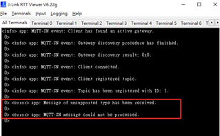

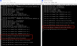

    2. I modify the CoAP code, but receive I got is not my topic data.
    I want to get my temp and counter data of CoAP topic.

  • Hi Jørgen,

  • Hi Rick,
    1. "fdaa:bb:1::2" is he address of the NAT64 interface, which redirects the dns request to the DNS64 service. See your ifconfig output:

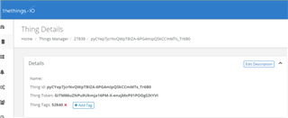

    2. Looks like the URI also needs to include "/resources/". I checked that this code works for getting the counter-value from thethings.io cloud by pressing button 4 (make sure to input your token ID):

    I used another board running the original example, to post updated counter values.

    now  I try this example  "Thread MQTT-SN Example".
    after i compile the code than i do the step below
    1.Build the example according to the instructions in Building examples.
    2.Turn the MQTT-SN gateway on according to the instructions in Thread Border Router.
    3.Program a development board with the MQTT-SN Subscriber application.
    4.Program another development board with the MQTT-SN Publisher application.
    5.Let the clients find the MQTT-SN gateway by pressing Button 2 on both boards.
    one of the FTD get kick out , when i do the 5 step
    and the error message show up
    "0> <error> app: Message of unsupported type has been received.
    0>
    0> <error> app: MQTT-SN message could not be processed."
    so the border router seems to be can only connect to one FTD
    if i connect two devices in the same time one of FTD will be kick of
    is there any reason may cause that? Or i miss some step need to be done?
    Please help me,thanks
    Best Regards,
    Rick.
  • Can you check which message type you are receiving when this problem occurs, for instance by printing it in mqttsn_packet_receiver.c:949:
    NRF_LOG_ERROR("Message of unsupported type has been received: %d.\r\n", message_type);
  • Hi Jørgen,
    I get the message_type is 1.
    both are the same.
