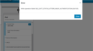

Is it still possible to remove bond in CTS?
I saw this statement about current time service on a previous ticket and trying to find out if it is true:
"IOS doesn't allow access to the characteristic unless the device is bonded"
https://devzone.nordicsemi.com/f/nordic-q-a/38214/remove-bond-in-cts/165249#165249
I tried ble_app_cts_c in both 15.3 and 17.0 (extra code added in 17.0), with same results.
Using an iphone 7 with ios 13.5.1, I can get CTS without changes.
With changes:
Time is read from ios until line 724 is commented, at which point pressing button 1 yields no results.
// pm_handler_secure_on_connection(p_ble_evt);
(Setting, #define SEC_PARAM_BOND 0 , generates a fatal error while viewing in RTT so left at 1)
Made the following changes to 17.0 SES DK832,
1) line 126 set to 0
2) comment line 724
3) add lines at 736
// Discover peer's services.
err_code = ble_db_discovery_start(&m_ble_db_discovery, m_cur_conn_handle);
4) line 944 set to false
init.config.ble_adv_whitelist_enabled = false;
It seems to have been possible to remove the bond in CTS a couple of years ago.
Apart from above, can the bond actually be removed and obtain time from ios using the latest versions?
thank-you,

    I have not seen anywhere that you don't need bonding to access the current time service. Where is that information coming from?
    I tried to access this in nRF Connect without success, due to insufficient authentication:
    I don't understand how to read it from the bluetooth web pages anymore (they changed the layout), but perhaps you can point me to where it says, if you know where to find this information.
    Remember that even though it is not mandatory to protect a service with security, they may still do it as an addon.
    best regards,
    Edvin

    Now after a couple of years it seems by looking at your nRF Connect test,
    that it is now no longer possible to access CTS without bonding.
    I was looking for a double check to be certain.

    The description from Sigurd is correct. That is how you remove the bonding in an example. And it may be correct that pairing (short term bonding) is not required by the Current Time Service by the BLE specification, since I can't find that requirement on Bluetooth's webpage.
    However, when I test with my iPhone, I am not able to read the CTS without encrypting (pairing or bonding) the connection (as you can see in the screenshot in my previous reply). This is something they can add themselves. So perhaps the user in Sigurds ticket, which you linked to, was not testing against an iPhone, but something else that doesn't put the encryption requirement on the service. He/she doesn't mention what the central in the connection is, as far as I can tell.
    Now, I am not sure whether you got that far that you actually tried to read the CTS characteristic or not, or if you stopped at the SEC_PARAM_BOND 0, since it threw an error. If you define DEBUG in your preprocessor definitions. Then the log should point to the APP_ERROR_CHECK(err_code) that caught the error.
    I guess the pm_sec_params_set() returns != 0 (NRF_SUCCESS). Try debugging into it with SEC_PARAM_BOND set to 0.
    You should be able to disable bonding, but please be aware that at least on my iphone, I wasn't able to read the CTS without at least pairing.
    If you are not sure about the difference between bonding and pairing, please check out Einar's answer in this ticket.
    Edvin
