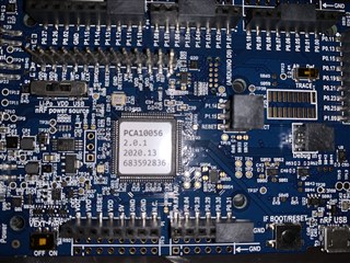

  • There is only one VDD pin, on aQFN73 ball assignments it's A22, on WLCSP ball assignments it's B3. You're confusing regulator decoupling pins with a supply pin.
    Also, Jörg is correct, you've likely fried the analog input when you supplied 5V to it, I suggest you consider it broken (for now) and use one of the other analog input pins when testing the SAADC.
  • Hi Haakonsh/ Jorg,
    Thanks for the reply. Hope A0 pin is not burnt even though I connected to the 5V for few seconds. I first connected A0 pin to the 3.0 V. It still did not show a valid output.
    I was referring to the VDD pins in nRF52840 DK highlighted in Red in the above diagram. When I measured using the Multimeter it reads 3.0V. But ADC reading values don't seems to be correct. I simply connected a wire as shown above in Green.
    I am now using A1 pin. Still the same observation. Any idea what could be the reason?
    Thanks a lot!!

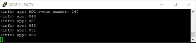

  • I measure ~850 when connected to VDD (~3.0V):
    With a gain of 1/6 and an internal voltage reference of 0.6V the input voltage range is 0-3.6V, and the expected output from an 3.0V input with 10-bit resolution is 3.0/3.6 * 1024 = 853.34.
    If you do not see ~850 as the output when connecting the analog input to a 3V source then the pin is most likely fried.
    I now can see ~850 when I define NRF_SAADC_INPUT_AIN1 in the code and use pin "P0.03" to measure VDD (3.0V).
    However, when I define NRF_SAADC_INPUT_AIN0 I am unable to measure from pin "P0.03".
    Isn't "A0" = P0.03 = NRF_SAADC_INPUT_AIN0 ?
    If I define NRF_SAADC_INPUT_AIN2 in the code, I can use pin "P0.04" to measure VDD.
  • See Mapping of analog pins.
    AIN0 is the p0.02 pin on the opposite side of the DK.
    Thanks for the reply. I have few more questions to clarify.
    1. The confusion happened because in my board it is printed as P0.03 (A0). Please see the attached images. So I thought NRF_SAADC_INPUT_AIN0 is for P0.03. In the other side of the board I see P0.02 (AREF). Is this the Pin for the channel NRF_SAADC_INPUT_AIN0? However AIN0 is not mentioned in the pin mapping table.
    2. If I define NRF_SAADC_INPUT_AIN0 as the channel, does it mean the ADC samples only from P0.02? Because initially I used P0.03 with the 5V, the reading was a low value than ~850. Maybe since it wasn't sampling from P0.03, it did not cause any damage. With AIN1 defined I still get a valid reading from P0.03 now.

    1. See aQFN73 ball assignments for the MCU.
    2. "Maybe since it wasn't sampling from P0.03, it did not cause any damage."
      It's the ESD protection diodes on the pins that are likely to be damaged, they are always present no matter the state the MCU is in.
      "With AIN1 defined I still get a valid reading from P0.03 now."
      Then you're lucky. The ESD diodes can handle a tiny current for a very short time before they blow, they are likely degraded, but still functional.
    3. If it's a floating pin with long traces then it's likely that you're capacitively coupled to other current sources. It depends on the routing of the trace.
