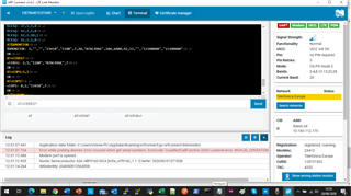

I did connect with LTE Link Monitor and there was a connection to the Telefonica network and I can see the GPS details there but not in the nRF cloud.

    After reading the log I have to aske you to test the at_client application for the Thingy:91, when you have that running on the Thingy:91 then you have to do a AT%XMONITOR and AT+CEREG? in the LTE Link Monitor , here is a link
    you will get something similar to the following:
    AT%XMONITOR
    %XMONITOR: 5,"","","24201","76C1",7,20,"014AA000",228,6400,37,31,"","11100000","11100000","01011001"
    OK
    and
    AT+CEREG?
    +CEREG: 2,5,"76C1","014AA000",7
    OK
    Could you report back the response you get ?

  • Hi Jonathan,
    Details as requested are below.

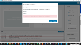

  • The upgrade is failing see below screenshot. I have followed the instructions as per the link.

  • Hi Asif,
    Two things:
    First
    1. Connect the device to your computer whit a USB cable while the device is powered off.
    2. Press and hold SW3 (button in the center of the device), while holding the button down turn on the device by switching the power switch to the ON position.
    3. Reals SW3 (you don't need to hold it down if the device power on successfully)
    4. Select device in nRF Programmer app
    5. Add Hex file
    6. Click the Write button in the nRF Programmer app.
    your device should be in MCUboot mode and successfully be programmed.

    However in your previous comment the feedback shows the following:
    "11100000","11100000" from your XMONITOR output indicates that that PSM is disabled, this means that the asset tracker application will not be able to get GPS data.
    What you saw in your log is A-GPS data which stands for assisted GPS data and is information downloaded from nrfCloud to help get a GPS fix faster and not in fact GPS position data.
    So since the network has not enabled Power Saving Mode (PSM/eDRX) for the IBasis sim at your location the asset tracker application will not work whit the GPS functionality. In the asset tracker application when the device enters Power Saving Mode (PSM) from the network, which, when granted, will let the GPS operate uninterrupted by LTE for the duration of the PSM interval, or until the device itself initiates a data transfer. The reason for this approach in the asset tracker is power consumption. If PSM is not granted then the GPS cant operate.
