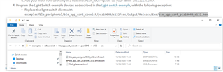

I am trying to follow the tutorial SDK UART coexistence example, but it seems like the last step cannot be completed. As you can see, that .hex file does not exist in the folder. Do you have any suggestion?

The Output folder in .../pca10040/s132/ses/ and all the files in it are generated when you build your project. Try building the ble_app_uart_coexist example in SES. The folder, and then also the .hex file, should be then generated, and you should be able to find the file.

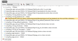

Hi. Trying to build the example (did not do any modification), these errors occur:
The problem is that the components folder does not even exist in the Mesh folder, but rather in the other one (SDK folder). And the global macros in SES are defined as:
SDK_ROOT=C:\SESProj\nRF5_SDK_1530
MESH_ROOT=C:\SESProj\nrf5_SDK_for_Mesh_v320
Do you have any clue why this happens? Thanks.
Problem solved.
Solution: the project needs to be run from ...\nRF5_SDK_1530\examples\ble_peripheral\ble_app_uart_coexist\pca10040\s132\ses (not from the Mesh folder).

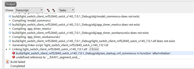

Hi Marte Myrvold! I have some updates and a question about my progress.
I installed SDK Mesh 4.2.0 and SDK 17.0.2, so that I can run the nRF52833 example.
Unfortunately I get this error and it happens for all projects in my newer Mesh folder.
Do you have any idea why this happens? It's an unmodified version, downloaded from the official website.
As a note, I have included the correct path from Options - Building - global macros.
